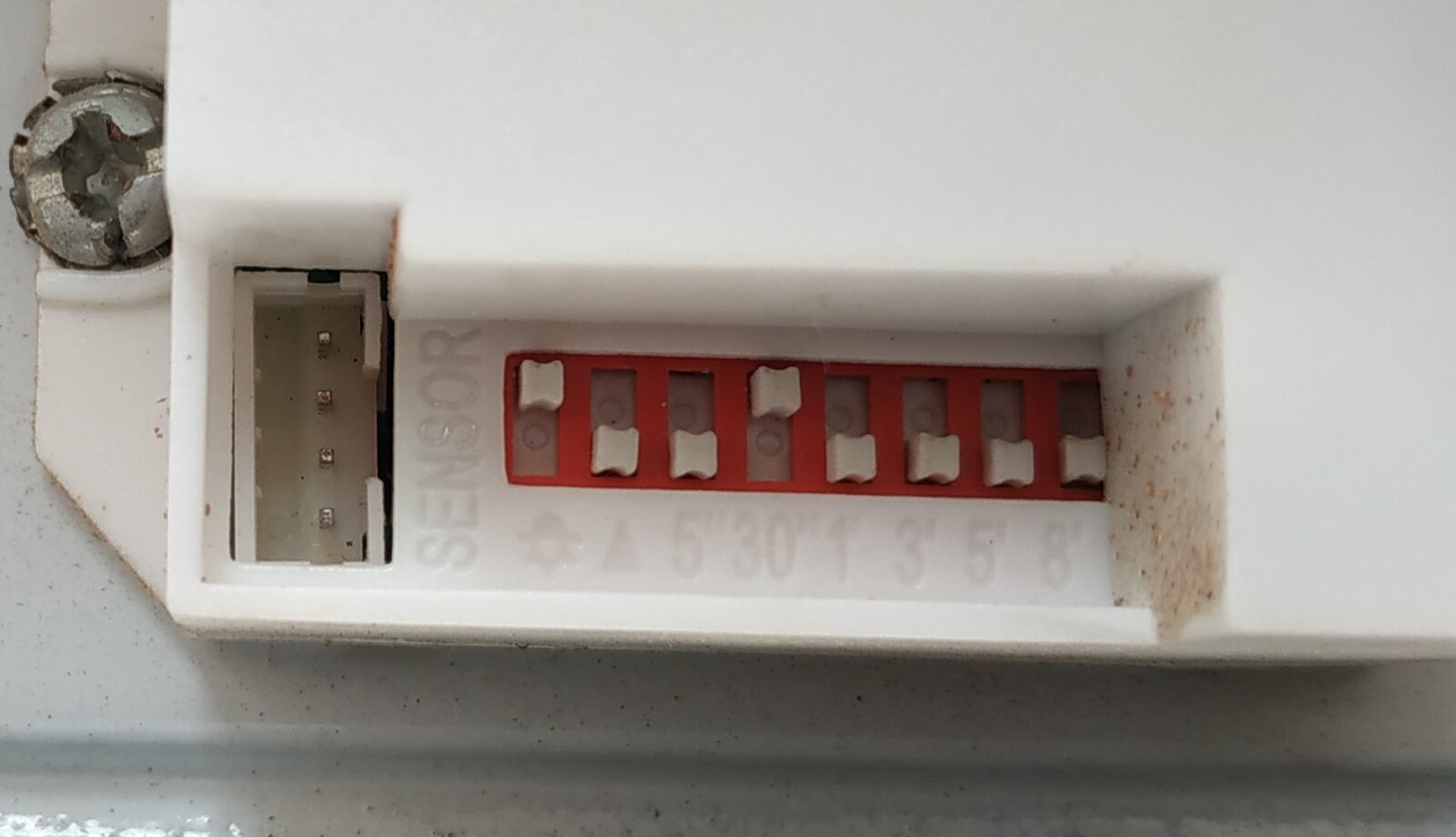

I have a PIR sensor porch light.
It doesn't seem to be functioning well e.g. not coming on when it's supposed to and vice versa.
I was never really bothered about this light until now since I'm setting up CCTV. I inherited this light when I bought the house so I don't have the instructions for the PIR settings.
I have phoned the company who made it and they said they will pop a copy of the instructions in the post but the text is very small as they are struggling to read it!
In the meantime and in case I can't read the instructions, can anyone work out what the settings are and mean? I'm not sure if they're generic, therefore, basically apply to all PIR sensors.
I want the light to come on only when it senses movement when it's dark. As said, the sensor might be faulty so I may have to replace the whole thing, it's at least 7 years old.
Thanks very much and hope you can help.
not 100% sure - but looks like you have two settings for brightness level to trigger - 1st switch
then 2nd
maybe the angle it triggers at - wide or narrow
then the other switches are for distance
so i would say its currently set to Wide Angle , 30" distance away to trigger
looks like 5", 30", 1ft 3ft 5ft 8ft - distance

Yes, it does look like it says 5" and so forth, but didn't think it would actually mean 5 inches as I don't see the purpose of that distance. Also, 30" is nearly 3' anyway so I thought it meant something else.
I'm wondering if one switch (maybe the first one?) turns on dusk/dawn mode thereby cancelling the others. I guess I'll have to try the setting and see what happens, but if it is faulty then it may be difficult to figure out....bum.

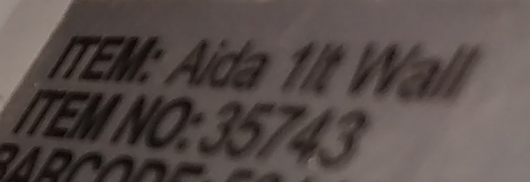

This is the make and model made by Poole Lighting Ltd. Tried searching online myself to no avail.

Perhaps it's seconds and minutes.
Google the make, model number and "instructions".
yep, 5" did seem a bit strange , so maybe not the meaning i thought
Maybe its the time ON
5 seconds
30seconds
1'5" often shows mins and seconds
so maybe its also seconds and minutes ON
I tried a search and included DIP Switch, which is what you have an image of , no real answers
I would try it and see
what you call the Dawn/dusk, maybe that works regardless of daylight and the setting is OFF , so works all the time and ON for sensitive to daylight , only comes on at night
Got it!
Make and model doesn't come up with anything so just searched 'PIR sensor settings' instead and looked under Google's Images section, halfway down the page there it was, not the light but the PIR control unit in this different product.......assuming it's the same!
Instruction available for download too! You're right, it's seconds.
