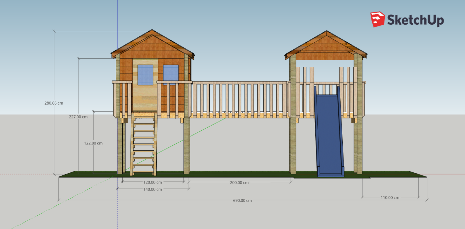

I was looking at building something much more substantial, as per image below - but this would also have a veranda and also the raised platform/bridge.
Given that planning is £206 to apply for, that is a serious amount of money to me.
Anyone know any better or confirm for certain what I have found?
I know I can speak to neighbours to see if they would object etc, and the height/eaves fall within the permitted measurements, and it would be at least 1m from any land boundary - I can understand it for extensions etc, but does the 30mm restriction really apply to play centres? it really does seem ardourous.
Planning would technically be needed. It is still an outbuilding, and if you took the building bit away there are still rules about decking. Whether it would be enforced is another matter. Your call if you want to risk it, I think I would unless I had particularly grumpy neighbours.
All designs shown would require P.P. because of the verandah. In particular, it falls foul of the condition in E 1 (h);
[not permitted development if]..."it would include the construction or provision of a verandah, balcony or raised platform"
