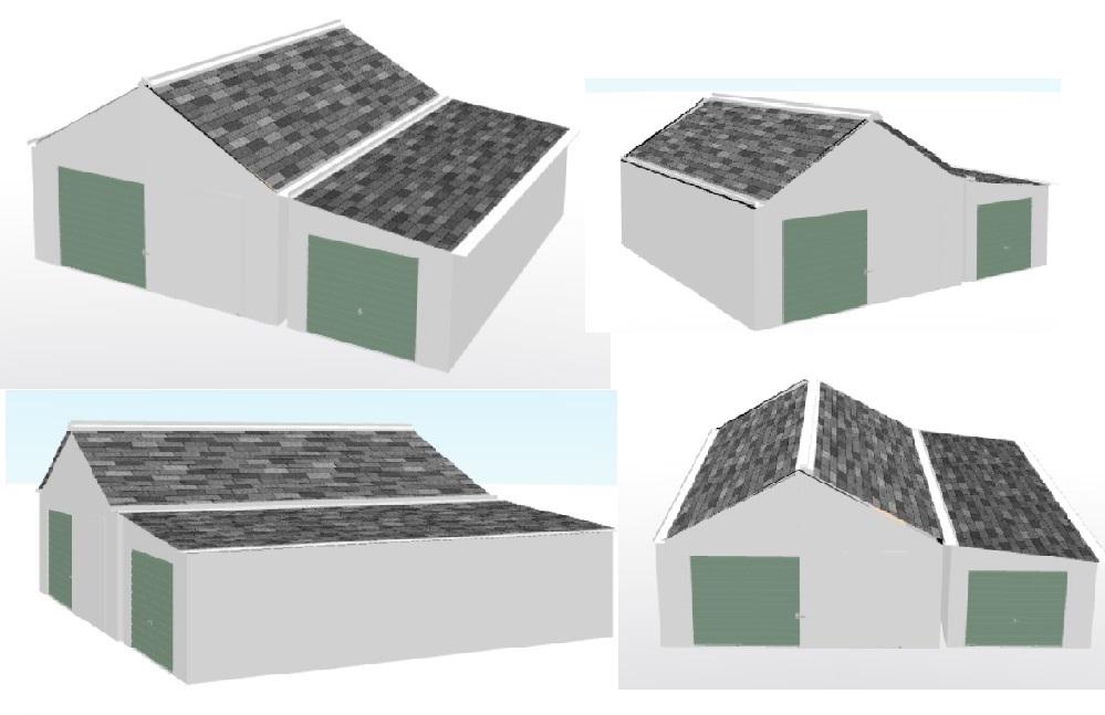

The OP has actually posted on another forum where some 3D elevations had been provided. Those show the existing gable roofed Garage with more of a lean-to roof for the workshop. To me, PD guidance wouldn’t see that as a dual pitched/gable roof hence the overall height being restricted to 3m.
Attached for reference.
