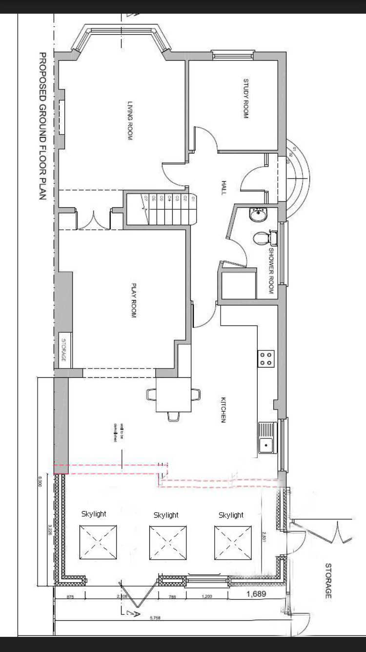

Hello! Just trying to work out whether it falls under permitted development to add an internal access door from new full width kitchen extension to existing detached garage (not changing use, converting, or rebuilding garage). We will be leaving the garage exactly as it is. A full width 6m rear extension would touch the garage wall so a connecting door would seem obvious, but would i need planning permission for this as it extends beyond the rear wall of the house by > 6m? or is this less important if i am not building
a new garage? i could leave a few inches gap between the two structures but it seems a bit silly...
Thank you all
I did pretty much answer this on the other thread, but to reiterate:
When you attach the extension to a garage, you no longer (in planning legislation terms) have a detached garage.. You have one large extension from the house, in this case both a side and rear extension.
Whether or not you have a door there is a bit irrelevant in planning terms; if it's connected, it's one big extension, which serves to provide a garage and lounge (or whatever it may be)
If you leave them separate then you have one single storey rear extension (judged on it's own merits) and a detached garage which is standalone and is having now extensions or alterations to it
The adding of a door is not subject to planning control in this context, so would not matter.
The pertinent question is really whether the extension is PD or not, and I'd argue that it is if it falls within the other size constraints, and the attachment to an original outbuilding wont make a difference.
In any case, a 1mm gap means that its not attached.

The garage is original as there are no plans available online for it, and all the neighbours have similar detached garages which they have attached and converted via planning permission. however it does look newish ie whether a previous owner has refurbished or demolished and rebuilt i wouldn't be able to say. I would want this to stay a garage and would like to connect them for access only.
if having a few mm gap would keep the buildings seperate I would do it this way, but out of interest if i did join the buildings would anyone really notice (from my understanding building control aren't concerned with whether your plan falls under PD and our neighbours really won't be able to see or care if there is a few mm gap or not). The reason I ask is, if there is a tiny gap i will put an inward opening door in the kitchen and an outward opening door in the garage so it's practically connected and we can use the garage to enter the house. If it's likely that no one will notice anyways i would rather attach the buildings and just have the one door.

You make a convincing case. I have no reason to believe this is not original. I don't expect anyone will notice or care, but if i do get called out hopefully the "no harm done" for a minor technical breach should suffice. the distinction between original and non original outbuilding is just not information readily available anywhere. thanks so much
