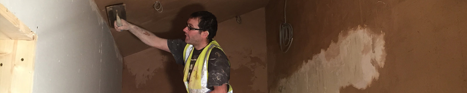

Hi guys, need some help and advice on doing my own painting in my loft, any advice?
