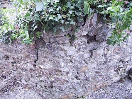

Plant growing through wall??
i removed about 5 of these today, does that mean my lawn is going to fall down?

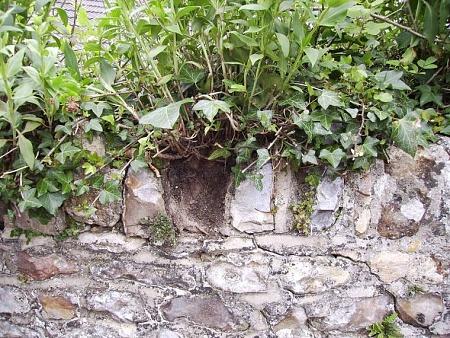

Stuart, the "dandelion" is Ivy and possibly Japanese knotweed. If you have not already cleared it, treat it urgent with strong weed killer
It's the wall of the local Chapel, so the Pastor killed off all the plant life. I think most of the damage was done by the ivy, although the other plants had damaged the top stonework. It's amazing how much soil and plant life can get into these walls.

"The natural world can have a devastating effect on old buildings. Even small plants can become a problem as their roots tend to break down mortar, and may even force joints open allowing water to penetrate the fabric."
"Plant tissues in the roots can cause incredible pressures as they grow."
"Weeds are so incredibly persistent that they will force their way up through concrete slabs."
Some councils: "Recommend spraying the sub-area soil below suspended floors with weed killer."
Dam maintenance throughout the world requires removal of weeds.
I've seen a number of situations where, with very little external indication, weeds inside of walls have forced out brickwork and caused enough damage to warrant a minor opening up and re-build.
We always spray weeds, never just cut them.

The biggest killer of the stone walls round here is the strong cement repointing which traps moisture and allows the plant life to survive.

im a gardener and find it difficult to even imagine that the sonchus oleraceus can cause cosmetic and/or structural damage to a building unless the building itself had turned to sand already. there are the obvious bamboos and knot weeds that pull foundations and walls apart, ivy, buddleia and a pyracantha can put a hole in your fence and pull it over or lift the roof from rotting timbers.. but most weeds are pretty much(with exception)incidental to structural decay and not the cause of it. go and explore a house and garden that has been abandoned for 20 odd years and check out the size of your average nettle or dandelion and send me some pics of them chucking beer cans through the windows or whatever youre accusing them of : )
