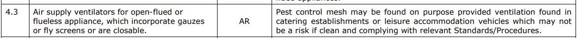

At the college where I work we have a plant room containing various equipment such as gas fired heating boilers, cold water storage tanks, electrical distribution boards etc.
Today we have had a gas engineer in checking/testing the main pipeworks and he has removed some 'fly-mesh' we had on the inside of the louvre doors, which were fitted by the builders 2 years ago. His claim is that it is against regulations. Builders are saying it complies.
Anyone know who is right? (in the hope someone can pointto a regulation and we can avoid a long drawn out argument between them. We just want a building that complies with the rules).
If there are no open-flued and no flue-less appliances in the plant room then one could consider 4.3 to be irrelevant in this case.

The plantroom is part of the main building and situated at the end of the right hand side of the front of the building. There are no windows in the room which, at a guesstimate, is about 12m x 12 m x 4m high. Access is via 2 metal louvred doors at the side of the building. There are no other acess or egress routes and the doors have a triple, tempered roller mortice style lock fitted. The louvres are large enough to get a persons fingers through, (based on an average persons hand size so I would say 20-25mm gap), and the mesh that was covering the louvres has 10mm squares in it. There are 4 boilers and their flues are fed up to the roof through 4 ceilings which are concrete slabs. Where any pipework or electrical cables pass through walls, floors, ceilings etc they are encased in fireproof cement with a minimum fire resistance of at least 2 hours. The room has a number of smoke/fire detectors, both thermal and optical. Obviously all lighting is flameproof enclosed.
Does any of this help to shed any light on it?
Fly screens / mesh can become blocked
stopping or restricting the air supply to any fossil fuel burning appliance
10 mm gaps ( ?) would not imo constitute a fly screen mesh
so imo is ok
if it opens to out side u may require it to stop vermin ingress into the room
mice ect ect
