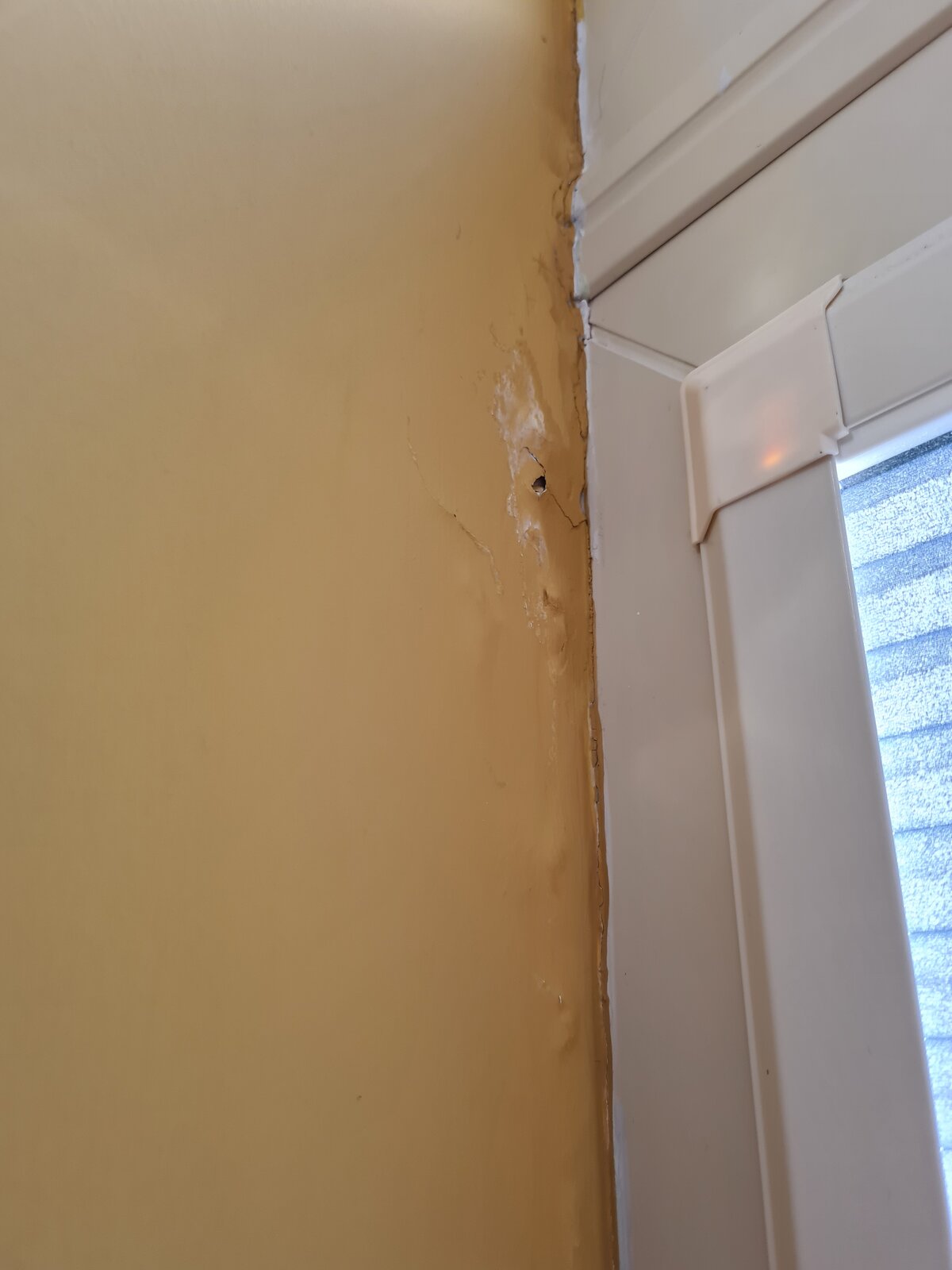

Plaster issue against double glazing.
24 Nov 2007
102
4
Near Lincoln
Any ideas what would cause this? Its not damp, just appears to have blistered. I'd like to be sure before i sort it.
If it is definitely not damp and water ingress, could it be cold bridging causing condensation, that is then disturbing the plaster/filler?
I think I would chisel out any bad areas, fill gaps with foam and cover the lot with uPVC cloaking profile.
Others may have better ideas! :)
It's a cavity wall. Just 3.4% moisture. Plaster skim has bubbled down where the double glazing is fitted. Less obvious lower down.
