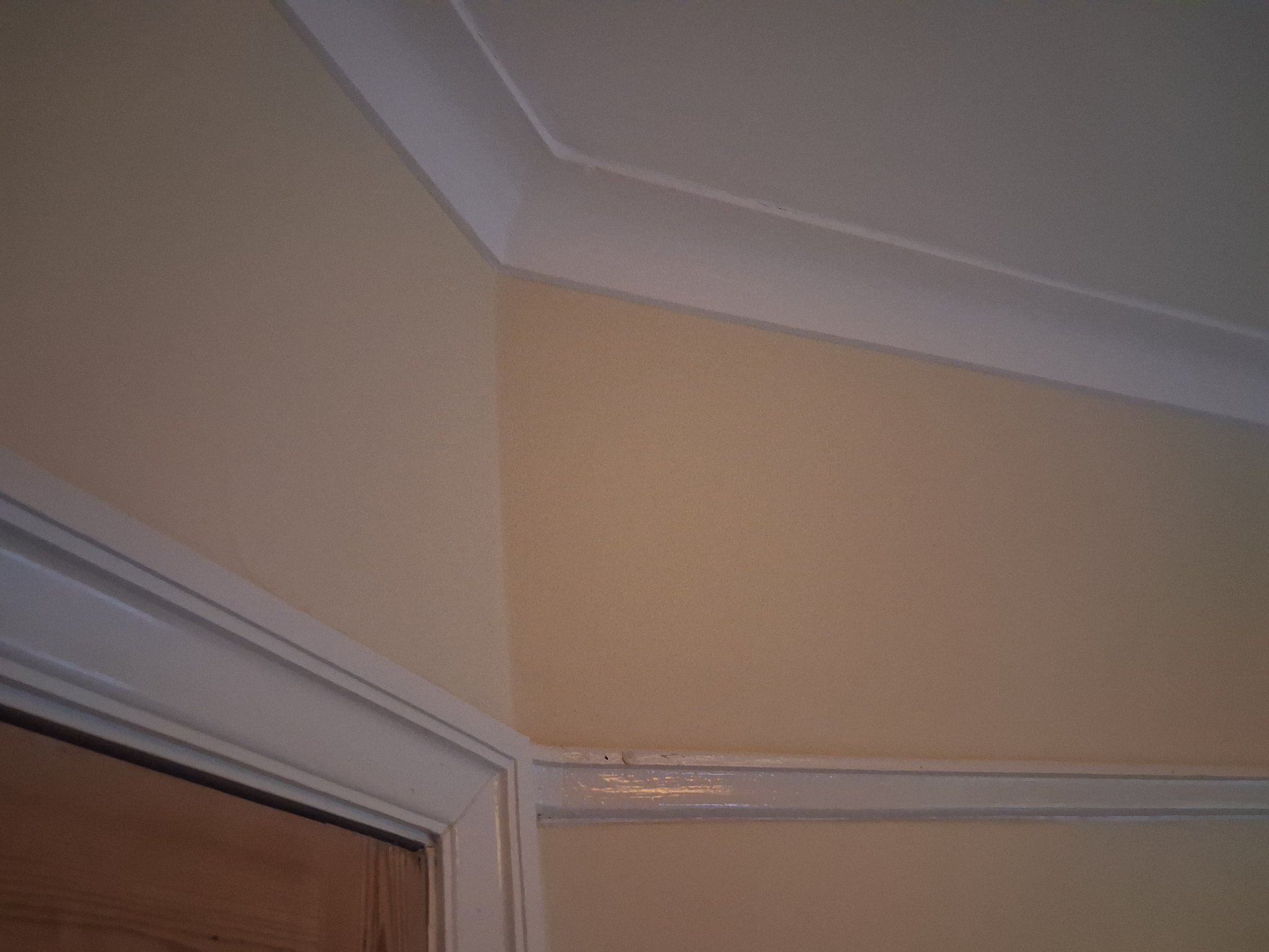

Hi All hoping someone can give ne some advice/options. So my house is 1930s and my front room plaster is fairly poor. Im wondering what are best options. Ive already knocked one wall back to brick but i have coving, original skirting and picture rails so im not sure what is possible with these in place. Ie do they need removing or can plastering still be done with them in place. Also is dot and dab an option or should I have it done with bonding and skim. Some of the ares are not straight and have slight curves so Im not sure plaster board would be an option. Ive got a couple of guys coming over to have a look but thought id also ask on here as I've had good advice for other issues

Thanks again. For the reply. Im not to bothered about insulation as I have a stove so can keep it nice and warm. Main thing was that I wanted to keep the original features ie woodwork (skirts and rail). Im not sure on the coving term but presume its running (see pic) ill have a look at the limelite option

That just looks like modern 127mm gyproc coving.
Never worth saving.
Had it been running coving or decorative fair enough but not that if in right
Never worth saving.
Ok that makes sense. Would i also need to remove picture rails and skirts
