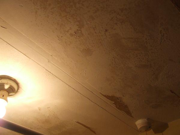

Basically, I need some advice regarding a Bathroom ceiling. We removed the 25 year old Artex as it was starting to peel and flake off. Only problem is, on doing so the difficult patches have taken some of the plasterboard lining paper away with it, revealing a cardboard-like texture underneath.
I've let it dry out and smoothed the affected areas down, but was wondering if it would be OK to skim plaster directly onto this (Scrim tape over the joints visible in the second photo), or would it be best to apply some (watered-down) PVA?

No you need to apply bonding agent but PVA isn't water proof. YOU would be bester taking it all down and boarding or boarding over the ceiling, I would not recomend overboard.
Bathrooms are small enough to take the lot down and reboard.
I don't like to over skim bathrooms because of the high moisture, water also breaks down PVA.

I agree, its best to rip it all down, then you can insulate, re board and skim. I would take it down your self, as you'll save your self a few quid getting the plasterer to do it. If you can rip it out, and insulate it, you only need to pay to get it boarded and skimmed.
