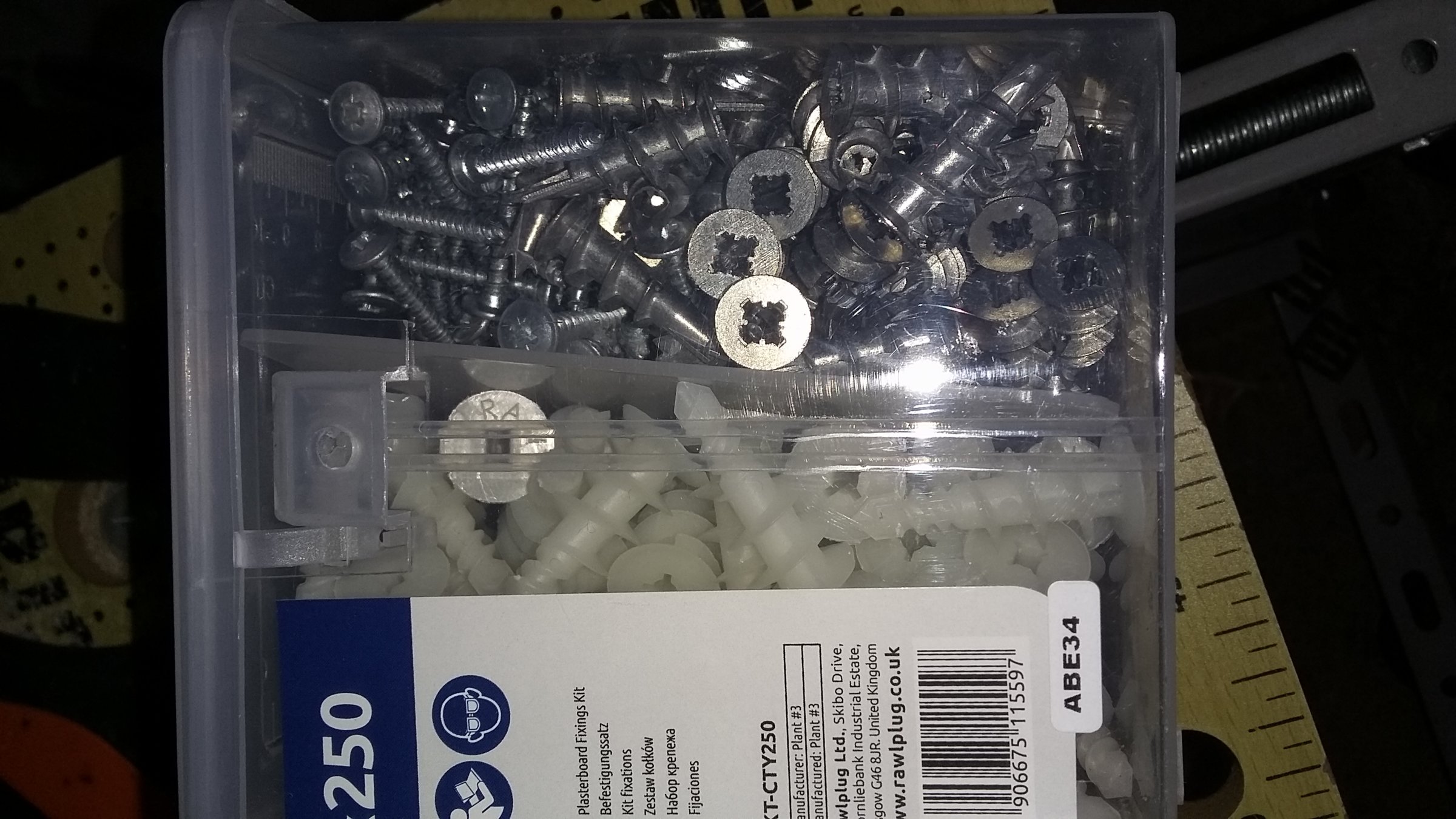

I need to hang up some pictures on a plasterboard wall so I bought some self drilling plasterboard fixings. I didn't know if I needed the plastic sort or metal, so I bought a tub with both of them. I hope these are the right fixings for the job - please let me know if you think otherwise.
But when should I use the metal fixings and when should I use the plastic fixings? (I did try Google but couldn't find the answer.)

Today I fitted some curtain rails using the metal fixings and after experimenting with a soon to be replaced plaster board stud wall, I ended up tapping threads in the fitting with the supplied screws first then drilled a 3mm pilot hole and wound the fixing in with a cross head driver. It seemed to place less stress on the hole and the screw could be undone easier if needed without winding out the fitting.
litl
Either or. Plastic is just a cheaper version of metal and both do the same job.
