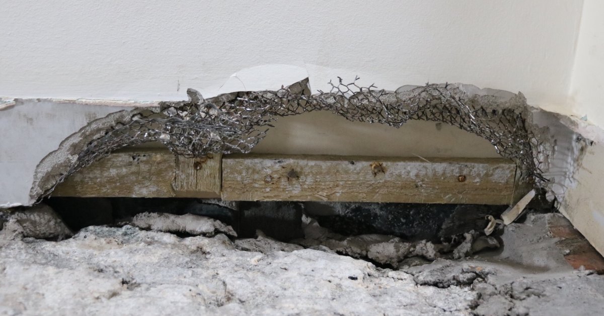

Some of my ceilings seem to be made from a single layer of plasterboard with a metal mesh embedded in it. I think this dates from about 1980, and it's a separating ceiling from the next flat. Is this for fire resistance?
I know that mesh is used for plaster repairs, but it really looks like it's embedded within the plasterboard. Did that exist or am I mistaken?
I've now remwoved a plasterboard wall lining and I can see the edge of this mysterious ceiling that I thought was plasterboard with mesh embedded in it:
It seems to be plaster on steel mesh lath. Hmmm.
The plan was to take this down and reconstruct it with insulation behind (and also the walls and floor; they seem to be as I expected thankfully).
Does anyone have experience with pulling this sort of ceiling down? Youtube has some terrifying videos but then that's true of most things.
How is the mesh normally fixed to the joists? I can imagine that it may not "pop off" in the way that plasterboard does from its screws. It's also not possible to use a magnet to find the fixings.

Mesh looks a lot like "Exmet" a proprietary material that reinforces Plaster.
Suggest you Google Exmet.
Because the "mesh" is a metal, a Magnet is of no use, If you need to remove the mesh a messy claw hammer will suffice.
Is the Image a wall or a ceiling?

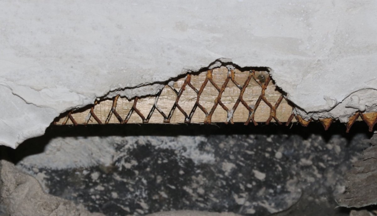

I've levered some of it out:
More surprises; what I first though was a joist is actually just a batten, and there is a layer of plasterboard above.
Feeling round the side I think I can feel the single layer of plasterboard then more wood, which presumably is the joist this time.
So what to so? The plan was to fit acoustic (e.g. wood fibre) batts between the joists and then re-board with two layers of plasterboard. But now I see that the ceiling is more substantial than I had thought, so perhaps that would not be any better acoustically. On the other hand, I now see that I have more space than I thought below the joists (the ceiling is relatively low so I can't lose more than a few mm of room height), so I could consider hanging the new ceiling on resilient bars or something.
(The two architectural technicians who looked at this thought it was a "typical Edinburgh ceiling", meaning that there would be boards half way up the joists with a layer of "deafening material" i.e. ash on top of that. But a previous upstairs neighbour told me she had had this removed "because it was dirty". No-one I've spoken to would believe that this could be true. Anyway lots of noise does come through and I need to do something about it from my side.)

As for the embedded steel mesh [Exmet] it is used to form a "Framework" to bridge a gap and allow the Plaster to bridge the gap.
