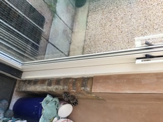

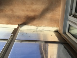

70F65DC2-1D91-4F94-8D1A-8D89A9094237.jpeg 59F6A0D4-8EBF-4FDC-A9AE-C7ACCD948F01.jpeg
Ok I have uploaded 2 files. 1. Of the wire beading to be replaced and of course what plaster and what finishing plaster.
2. This is also a similar situation where I have chipped away to the brickwork and I would appreciate the plaster I would require for that. (This pic is where the plaster had blown over years at the back entrance to the conservatory
if you don’t want to use sand /cement , the only bagged backing plaster suitable for that situation is thistle dri coat.
Many thanks Benny - so that is a definite - I will have to return the Undercoat plaster, Now do I just use that and then a finishing plaster. Why not bonding - I had a plasterer in may years ago doing an indoor chimney breast and he used a bonding 1st coat then as it went off he used a finishing plaster. Also can you advice do I need anything (as this is inside a conservatory ) do I need a watered down PVA Prior to starting. I do appreciate your help and hope the pics help (hope you did not have to stand on your head to view them) ps at this rate I might have to return all.
