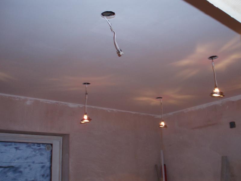

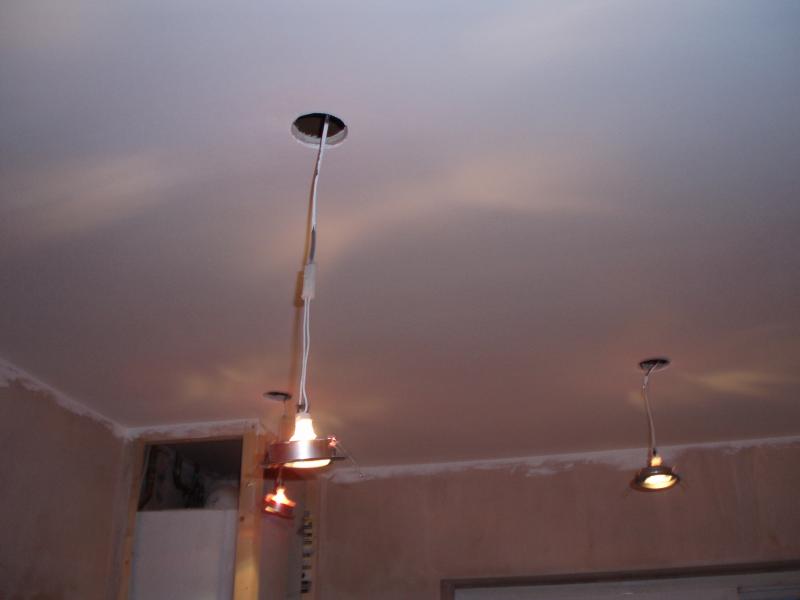

Just plastered my first ceiling using stop bead to break the ceiling into two parts. Found this to work well. Skim upto stop bead (two coats) remove bead then do other half of ceiling on same day. Found this trick on this great website. Put some pics in album.
