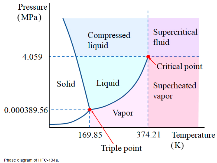

This subject gets very complex, and way over my head, but in simplistic terms, over ranges of temp and pressure likely to be relevant in context, it's generally true that, for any given pressure (within that range), there is a temp below which the substance will inevitably be liquid and, for any given temp (within that range), there is a pressure above which the substance will inevitably be gas. A simplistic 'phase diagram' for an HFC refrigerant may help you to understand ...
You need to concentrate on the regions labelled "Liquid" (light green) ans "Vapor" (light pink). We're not interested in the solid phase (white) and, as for the other three (when pressure and/or temp is/are above the values at the "Critical point"), they represent weird states ('above my head'!) where liquid and gas are not really distinguishable from one another!
so, simplistically ..... for any temp within that region, increasing the pressure will eventually cause the gas to become liquid, but with an increasing amount of presure required to achieve that at higher temps. Conversely, for any pressure within that region, decreasng the temp will eventually cause gas to become iquid but with an increasingly low temp required to achieve that at lower pressures.

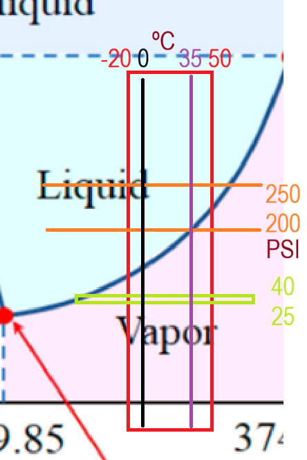

I hadn't expected to be going down understanding more of AC but here goes:
First this isn't my field but I have interface many AC units to BMS so yes I do se pressure gauges etc and yes I communicate with the AC guys.
I believe typical HI pressure range is 200 to 250 PSI depending on refrigerant and I'll go a bit further and say probably more like the top half of that and LO pressure around 25 to 40 PSI
Scrawling on your curve and hoping my guesstimations are somewhere nearly close please allow ±½ a house brick:
200 PSI shows a max temp of 35ºC and 40 PSI shows a minimum temp of -40ºC
I think those pretty much sum up what questions have been asked although to the uninitiated (Especially Sunray) it does appear different pressures could be used to move the cutoff points.
EDIT: TYPO the red box has been drawn as -10 to 50ºC not -20 as marked
I believe typical HI pressure range is 200 to 250 PSI depending on refrigerant and I'll go a bit further and say probably more like the top half of that and LO pressure around 25 to 40 PSI ... 200 PSI shows a max temp of 35ºC and 40 PSI shows a minimum temp of -40ºC ... I think those pretty much sum up what questions have been asked ....
Fair enough - but such exercises are largely 'self-fulfilling', in that the answers you get will depend entirely on what pressures you choose to feed in - and I haven't got a clue as to whether your 40 - 200 PSI assumption is 'reasonable' or 'wildly incorrect' ;)
I don't believe they are wildly incorrect - although well out of date possibly.
All I have done is calculate the pressure readings into PSI (Units I'm more comfortable with), add the red box for -10 to 50°C and black line for 0ºC and the green and orange markings for pressures I hope I remember then estimate the limits. No intention of being self fulfilling and if anything came up with figures I didn't expect.
I don't believe they are wildly incorrect - although well out of date possibly. ... All I have done is calculate the pressure readings into PSI (Units I'm more comfortable with), add the red box for -10 to 50°C and black line for 0ºC and the green and orange markings for pressures I hope I remember then estimate the limits.
Fair enough, but I still don't really understand where the estimates/guesstimates/whatever of pressures you've used have come from. Are they perhaps pressures which you 'know' (or, at least, 'believe') to be the range of pressures used in typical real-world domestic fridges and freezers? As I've said, I personally haven't got a clue about the pressures!

I believe typical HI pressure range is 200 to 250 PSI depending on refrigerant and I'll go a bit further and say probably more like the top half of that and LO pressure around 25 to 40 PSI...

AIUI all chiller systems using a refrigerant work in fairly similar conditions
Fair enough again. As I said, I haven't got a clue, so I'll have to take your word for it unless/until someone provides contradictory information.
On the face of it, AC systems are AC systems, and often have pressure gauges, whereas domestic fridges and freezers are domestic fridges and freezers, which very rarely have pressure gauges, so I personally can't be sure (from what you've said) as to how similar they are in terms of either refrigerant or pressures.
Quite so and I'll be very happy to be updated.
I did a very little google search last night and saw various figures within the ranges 0f 2-5 and 12-24bar (~30-75 and 180-360 psi) and a target figure of 1250KPa (181psi) in cars
