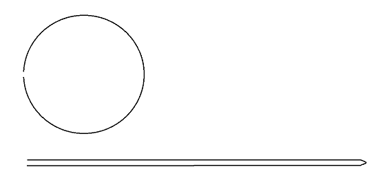

I would say it is more like comparing a ring to a line.
A 4 mm² radial can have up to approx 40 meters of cable, where a 2.5 mm² can have 106 meters of cable approx, so much depends on the size of the property, but in general you need more radials than ring finals to wire most properties.
