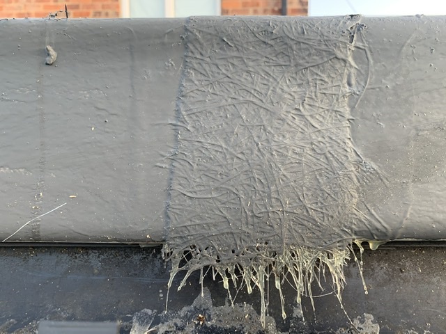

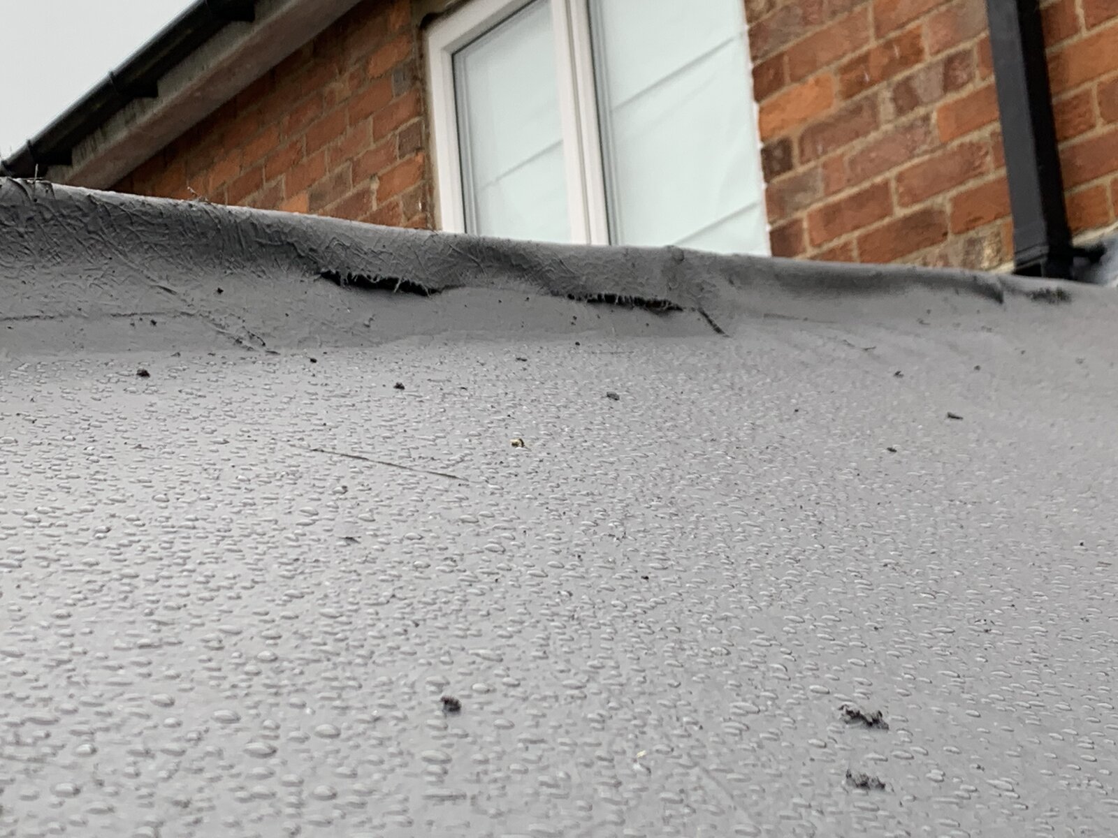

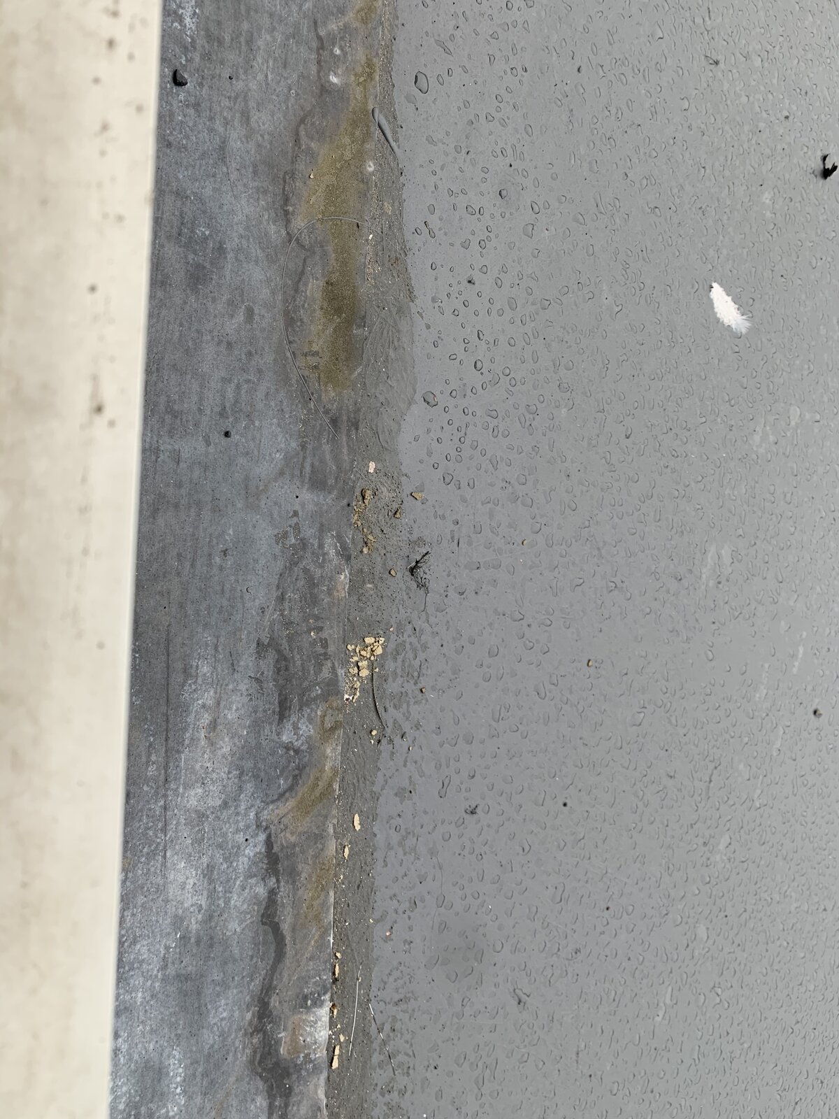

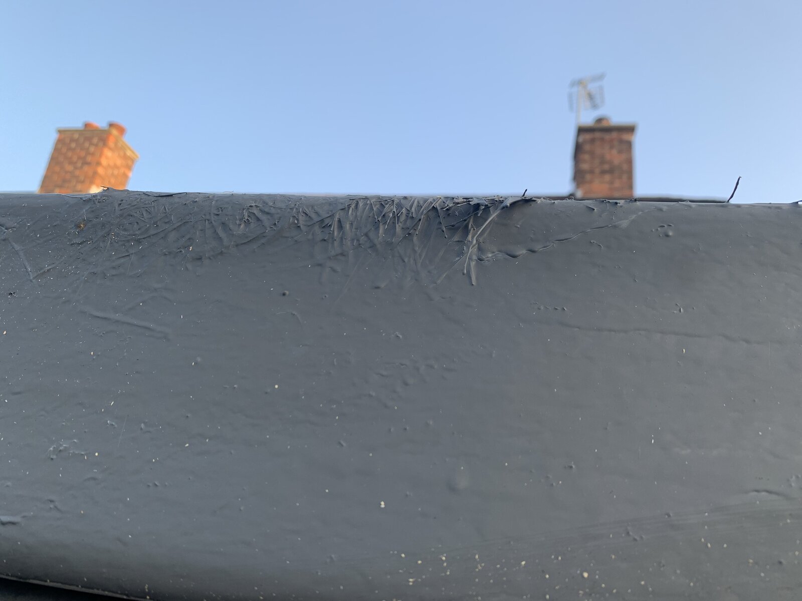

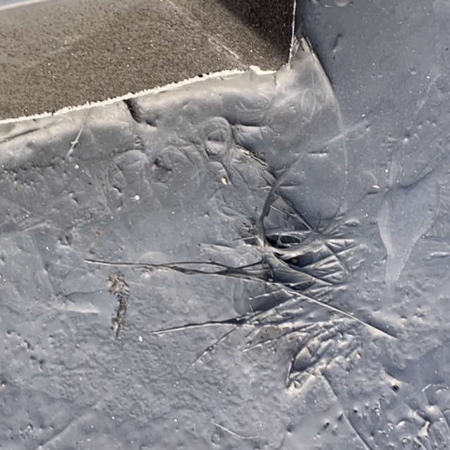

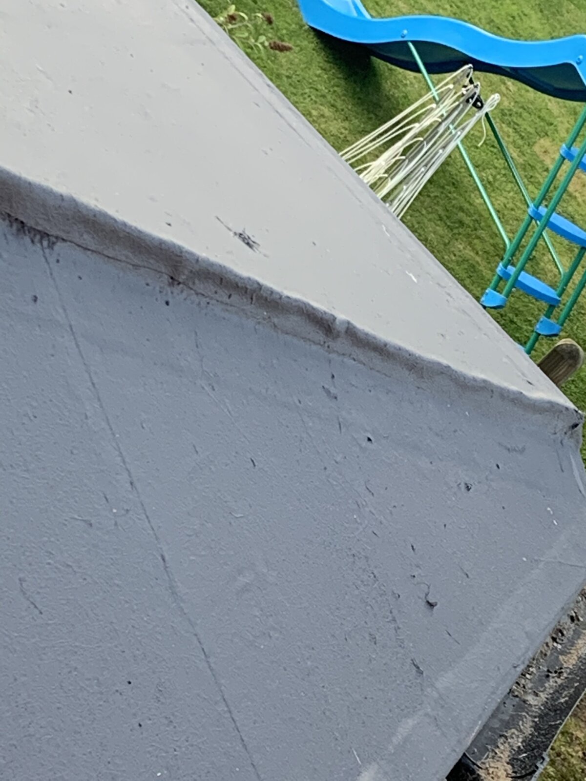

Hi,
I’m looking for advice. We have had a terrible GRP roof done on a kitchen extension. There are holes, rips, parts which have no coating. You can see all the matting.
The company have admitted the faults. They claim they will fix them but I don’t want them to just patch it up! Has anyone got any ideas?
I’m desperate, we paid £7000 which was all out savings to have this done after the roof that was put on by the original owners was the wrong one.

First one- CureIt guarantee the materials but if they did send a rep round he'd take one look and walk away- the pics show poor and incorrect application.
Pic 1- raggy bandage on a trim. Looks rubbish but not the end of the world, the raggy mat should have been ground off before topcoating but unlikely to cause any problems.
Pic 2- too much topcoat, probably dolloped on to cover a gap or a bit of mat full of holes due to lack of support. Grind off, relaminate, redo topcoat. This will always cause a visual difference so price reduction would be in order.
Pic 3. If there's a trim under that lot then again not likely to leak. Grind back, relaminate as necessary, redo topcoat, note as above regarding visual difference/price reduction
Pic 4 - not sure what i'm seeing there
Pic 5 - excess mat poking above a trim. Should have been ground off before topcoat. See above for repair requirements
Pic 6- looks like they've tried to mat over the top of an expansion joint trim. Odd place to put such a trim but if it is a proper grp trim then again unlikely to leak but clearly shows the installers had no idea what they were doing & were much more comfortable with torched felt.
Grind off, re topcoat.
If you've already paid them then you have to give them an opportunity to rectify the work. Get them to detail exactly what they have fitted (is the deck 18mm OSB? Is it T & G or square edged? Is it screwed or nailed to the joists? What screws/nails were used at what spacings. What trims were used at what locations- lengths and types. What weight mat was used? What date and batch codes were on the resin and topcoat? Get all this in writing (they won't know what dates were on the resin and topcoat cos no-one ever looks or cares, for aerospace the dates are critical, for rooves as long as it goes off it'll be fine. If they give you dates and codes, verify them with CureIt, when they turn out to be rubbish thats more ammo for you if you have to go Small Claims).
