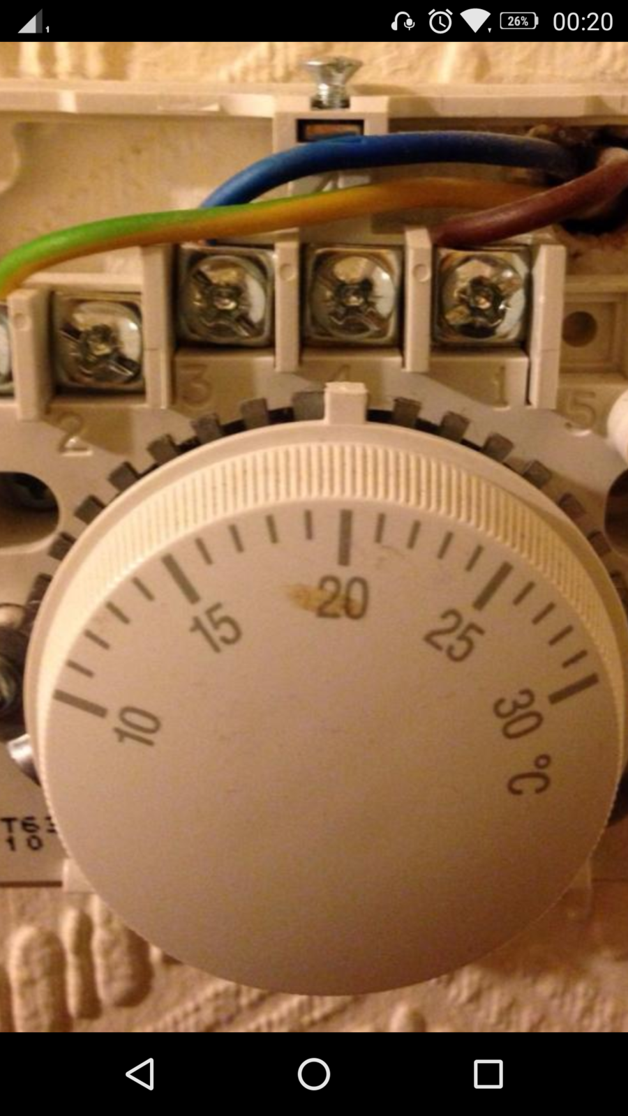

Hi. I'm new to this forum. Can any one help .
I'm planing to replace thermostat Honeywell T40 to new one digital. How to wire new one there is only two cables on old one. Pictures attached. Thanks
Your current wiring is not sufficient.
You have earth, live and switched live.
You need earth, live, neutral, switched live and switched neutral.
The switched neutral might not be essential but the neutral probably is needed.

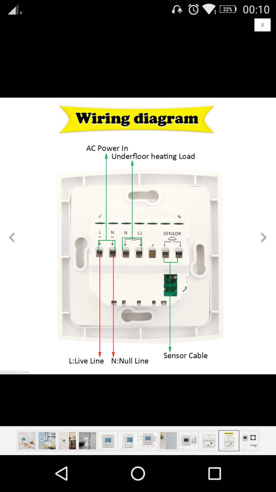

Thanks . Thats what I thought. Do you know any cheap digital which can work on this one. Thanks
No, but if you can find one that needs live and neutral only, and transmits wirelessly, that would do. Or you could power it off a nearby socket. If that, you would really need to move the rest of the heating system to be on the same socket circuit if it's not already though, to avoid surprises later for someone working on the heating.
I don’t think the digital Honeywell (non programmable) stat needs a neutral as it’s battery powered. Just line and switched line
