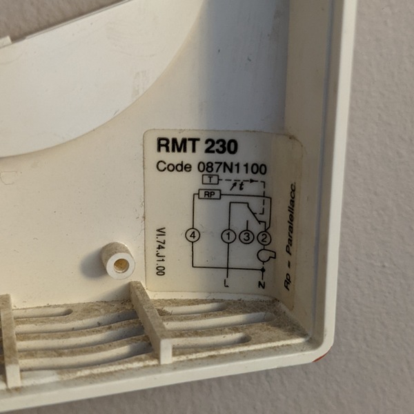

I'm trying to install a Nest Thermostat E but I can't get it to work properly - it always calls for heat. Its replacing a Danfoss RMT230 wired like this:
I wired in the Heatlink following the guide on this page:
https://support.google.com/googlenest/answer/9247634?hl=en-GB
Where it says terminal 1 on the Danfoss goes to C on the Heatlink, and terminal 2 goes to NO, so the Heatlink is wired in like this:
The old programmer is set to 'On' for Central Heating. Its a Danfoss FP715.
If I put the old thermostat back in the CH turns on and off depending on the temp setting as it should.
If I disconnect one of the wires from the Heatlink the CH stays off.
I've factory reset the Heatlink and the Thermostat E and re run the installation process, but it made no difference.
Any advice would be very gratefully received as I've no idea what to try next! Thanks for reading!

So swap it back to old Danfoss thermostat and try that? Will do, thanks! I'll report back with the result.
remove the wires from NO and COM and test for continuity between the terminals with no demand for heating, if open circuit Nest is fine , if closed circuit nest is where the fault is,
Got it, thanks. I disconnected the wires from the Heatlink and did as you suggest. At the Heatlink there is always continuity between NO and COM regardless of whether the Thermostat E is asking for heat or set to off.
I can hear a clicking noise from the Heatlink when it changes to off - but there is still continuity. So it's knackered?
I can hear a clicking noise from the Heatlink when it changes to off - but there is still continuity. So it's knackered?[/QU
disconnect everything, if you still get continuity then yes the contacts are fused
