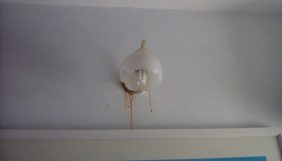

What are these marks please, and how do I fix it? (See pic) We're just about to sell!!! Thanks

water penetration, enriched with rust, coming through the drill holes, probably, though it might be dripping down the cables.
Is there a bathroom above?
Take a photo from the other side of the wall as well as a wider view of this side.
Agree with John D. Is it a bathroom with roof directly above?
Had similar in my old house, turned out to be water getting into the fitting from a small break in the slate of the roof. sorted that out and problem was solved.
