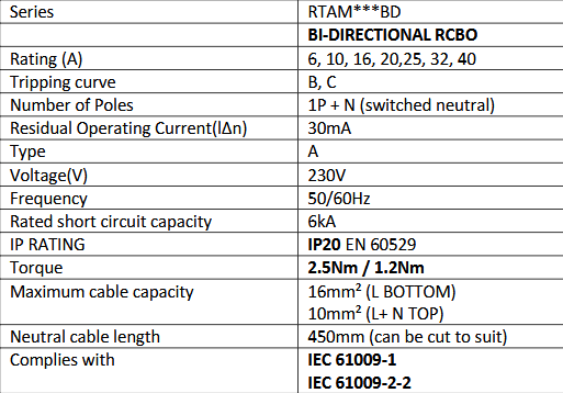

Also, the socket will need to be fed by a bidirectional RCD/RCBO etc. As it stands even in the trade, we have a problem identifying which RCD/RCBO are bidirectional.
So the rules would have to change so that all sockets likely to be used by a solar array are supplied by a bidirectional RCD/RCBO.

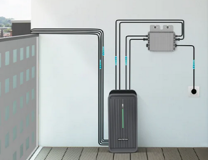

Sorry, just twigged as to reason why someone would say this. If we were to get a battery pack something like this.
Then you could set up a radial or ring final supplied from a unit like this to power items direct from the battery pack. And either charge the battery from solar or mains, so that it acted as an EPS the problem using an existing radial or ring final is the unit will not power over a set load, so you would need one set of sockets powered from the battery, and once set for high-powered items.
This has always been permitted, it does not require any G98 or G99 or DNO permission, could even have a split tariff and charge the battery overnight on cheap rate.
Ideal is to have a battery pack which can deliver over 3 kW, so any plug in item can use it.
My battery pack to start with was 3.2 kWh, it could be charged at 2 kW and could discharge at 3 kW, the problem was with any back-ground use items using 3 kW would still draw some power from the grid, and my solar panels were 6 kW with a 5 kW inverter, so with a part charged battery I was only charging it at 2 kW and the rest was going into the grid, so I doubled up on battery size, it is not that often that I am producing over 4 kW, and not using most of the extra kW in-house, so now I can store nearly all I produce, and I can draw 5 kW (limited by size of inverter) so rare (when I have a shower) that I am drawing more than the battery can provide.
So the difference between a pro install and a DIY install is the G98 or G99 allowing one to be paid for export, and use the existing wiring in the home. With a parallel ring final method you don't need a registered installer, but you can only self use the power you can't export it.
