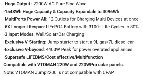

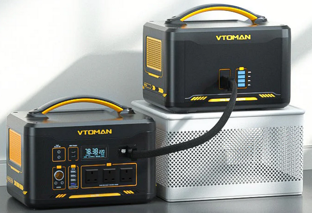

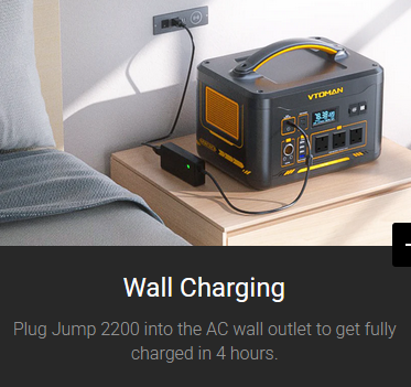

I did not read exactly what it could do, but the 3 input modes means likely it would work. Advert is here but not checked exactly what this one does. It seems you can expand them, 1755890638289.png but this 1755890751350.png does not show solar panels and grid charging at the same time, but can clearly be charged from a socket 1755890960328.png there are many more
they are basic the next level to the old jump start battery, I have an old one of these
which has a 300 watt inverter built in, and I want to renew the 20 Ah AGM (VRLA) battery so I can continue to use it, just under £40 for a new battery if I collect it from North Wales, mainly used to pump up my bike tyres, a portable cigarette lighter socket is handy. The built-in pump died.
All I was doing was pointing out the inverter and battery pack don't need to be grid tied.
I note my own solar panel inverter can be configured to work with a generator rather than the grid tie mode, and when set up to do that, it can start the generator at a set battery charge level, and it will recharge the battery, then stop the generator, but it is an either/or you can't have both. I looked at these power stations to replace my jump start unit.
