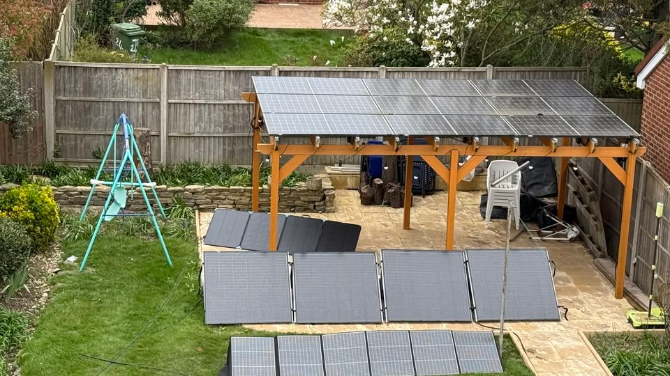

The battery box can discharge at maximum rate for battery through the socket on the front and supplement the deficit by drawing direct from the mains, so say 1 kW from battery and 1 kW from mains so a 2 kW output, and long as the output is less than 1 kW when mains is disconnected it will operate like an UPS, but since it will allow a mixture of mains and battery as it has grid tied, it can allow you to use part solar generated and part from grid.
The problem I have is the English, both types are tied to the grid, but one type back feeds the other type does not, I don't know of a phrase to differentiate between the two. They both grid tie.
As to feed into grid, as far as I am aware, my solar does not have an option to reduce its output so it does not feed into the grid, if my battery state of charge is below 100% then that will be charged first, and if my immersion heater calls for heat, that will also happen before and feed into the grid, but I have no way other than turning it off, or for the grid to be out of range, to turn the output off, at the moment 1 kW is going into the grid.
Only way not to feed into the grid is with say a 300 watts panel and a 350 watts back ground load.
