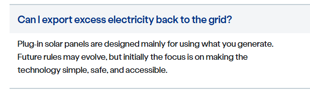

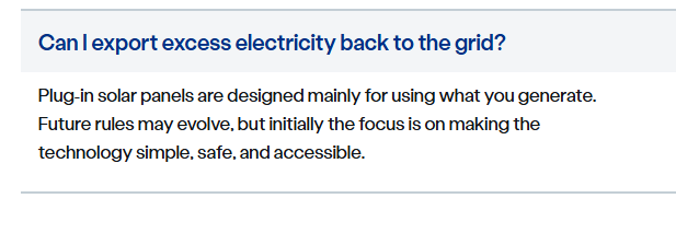

As to Plug-in solar panels – what are they, and how could they help cut your energy bills? By British Gas Energy. This is the firm who told me repeatedly that the reason I could not be paid for export was I had filled in their forms in the wrong format. The real reason was I needed a second MPAN number for export, and on changing to Octopus I got this within 2 weeks and started to be paid for export, so I take what British Gas says with a pinch of salt.

Thanks. I'll have a look when I have some moments and will then probably comment again. However, the little bit you've quoted seems to suggest that, at the least, they probably share my suspicion that export is not really a part of the thinking about these things - at least not initially?

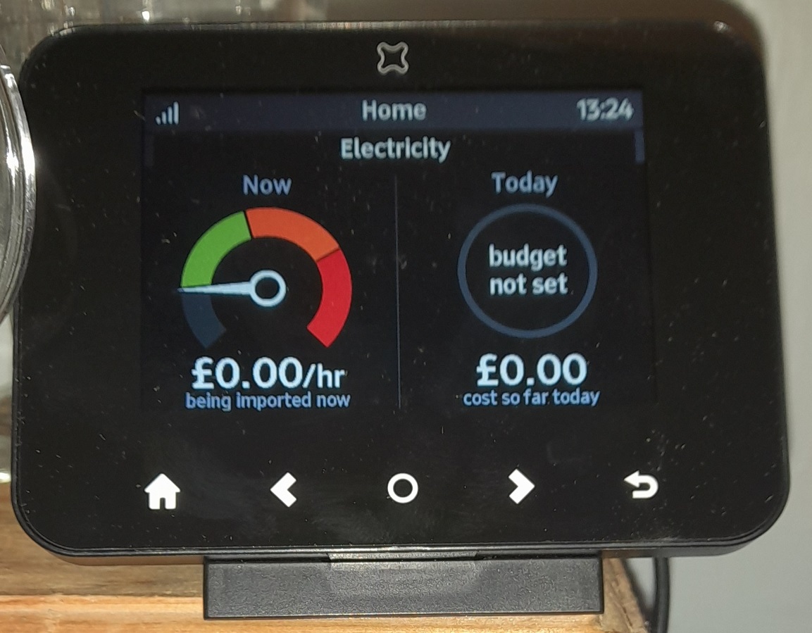

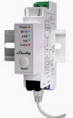

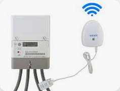

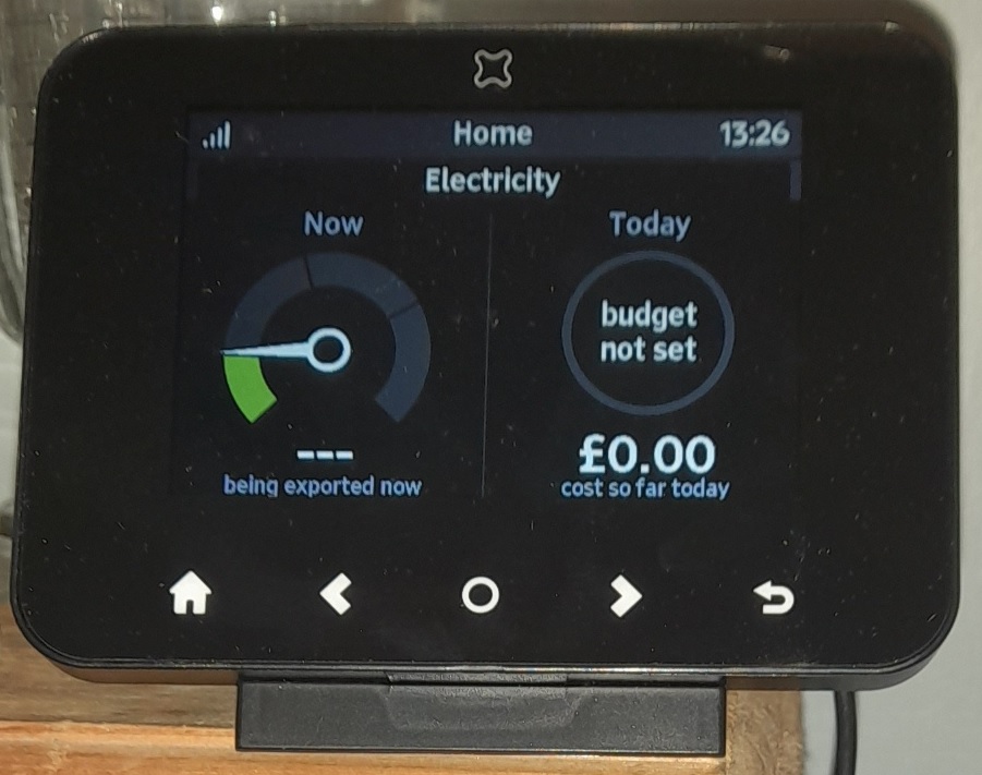

1780636117643.pngThe way iboost+ monitors import/export could be used with solar inverters, so no need to open the CU, but 1780636260205.pngthese seem to be the norm which need mounting in a box, the IHD (in home display)Exporting 1.jpgImporting 1.jpg keeps flicking between the two screens, however, solar and battery is very different to just solar.
With just solar, only thing which can happen to excess, is for it to be exported, there is no need to measure, as nothing you can do with it.
With solar and battery, measuring is essential, and the import/export line on the graph will be flat until battery either fully changed or discharged to the set limit.
