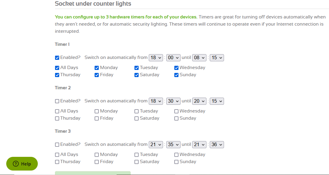

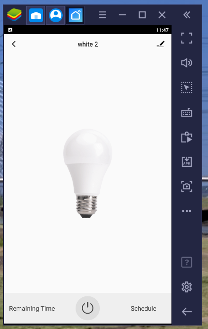

The smartlife app needs an emulator to run on PC, and it is very slow booting up, theory is great, in theory I can switch on and set the on time so it auto switches off.
I just set remaining time, but in practice it takes around 5 minutes to boot up, so a real pain. I do have a schedule set for some lights, but not really that good to use. The other one not much better it does boot up faster but upload_2021-10-1_11-55-12.png the setting are limited to 3 events, yes can use IFTTT to get more, but not as easy to use as I expected.
