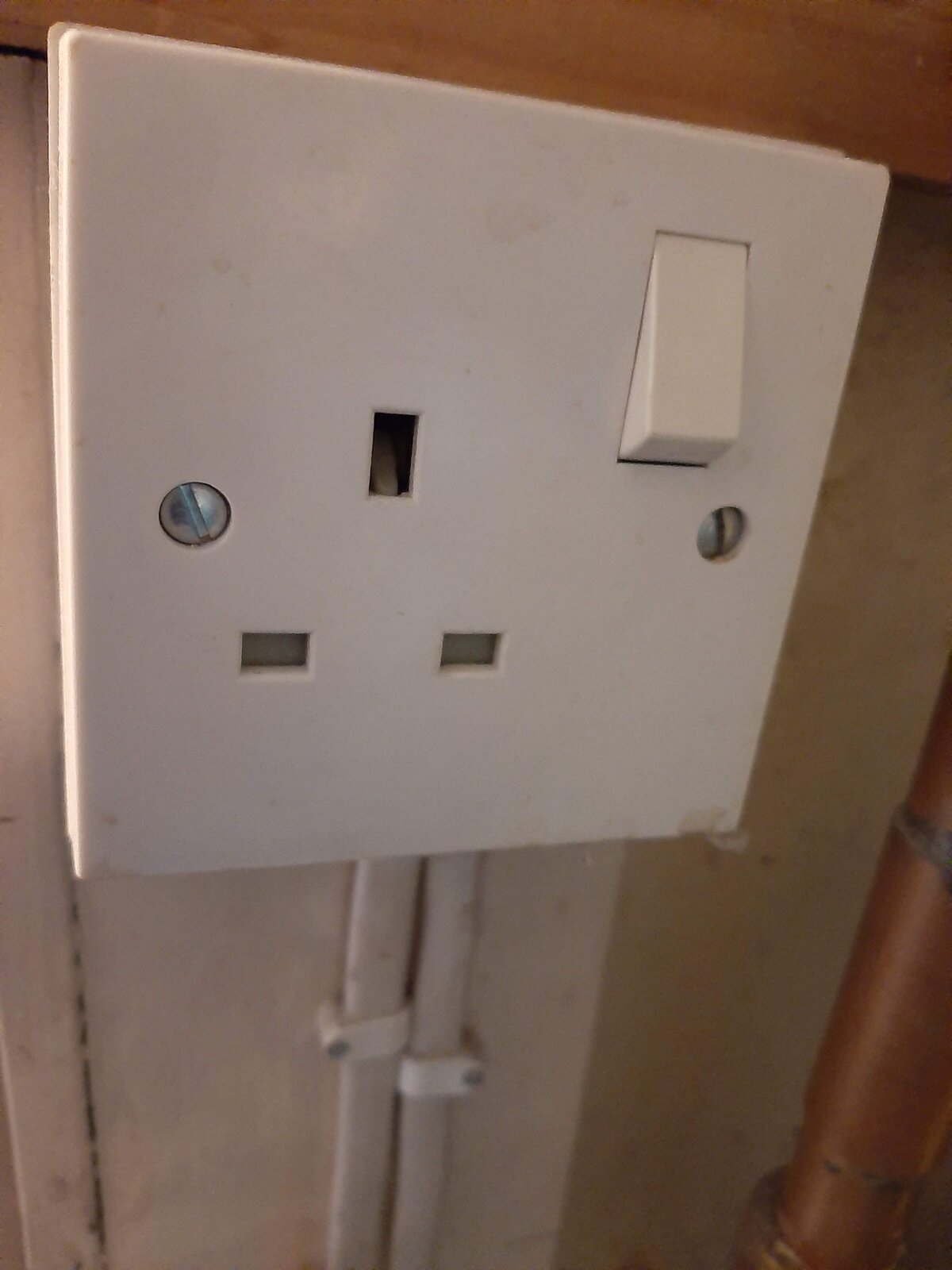

Here is a photo of the socket in my airing cupboard. Only the immersion heater is ever plugged in here. What could I fit in its place so that I could safely time the heater to come on and off? It is wired into the upstairs ring (before I moved in) but there are just a few radios and computers that use that ring so it's never overloaded.

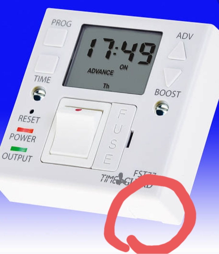

Thanks. I can't work out where the cable to the immersion would emerge.
