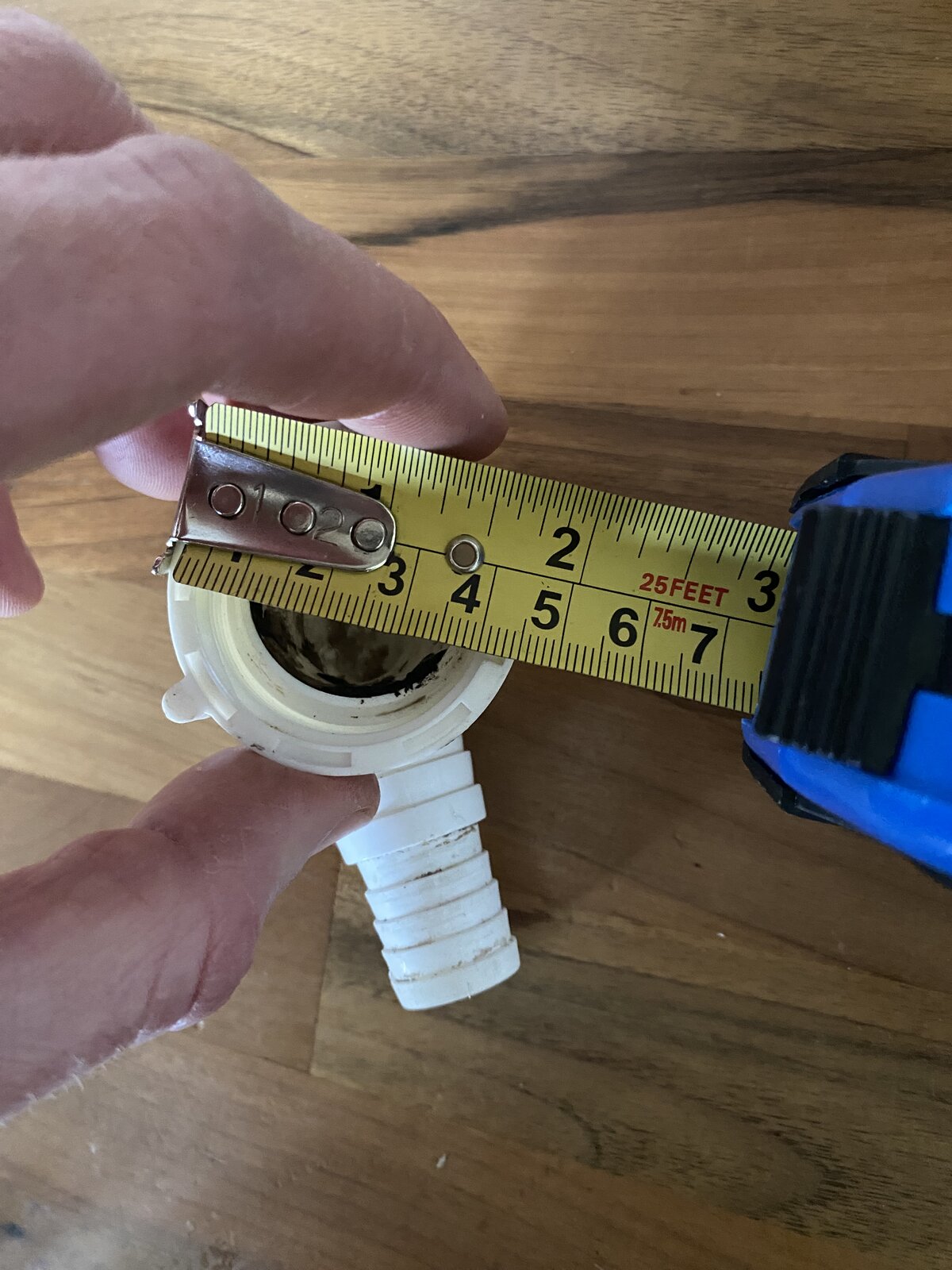

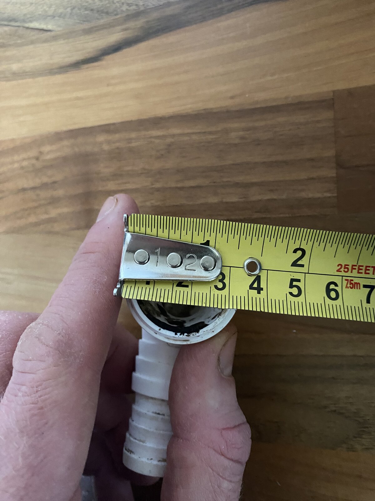

Hi, I need to buy another spigot for my dishwasher it’s currently got a blanking screw cap on, I am struggling to find the correct size.
The internal diameter of the current (washing machine) spigot is 32mm as per pic 2, but the thread size is 45mm as per pic 1
Where can I get the part from (a new spigot with correct thread cap)
Seems so simple Job but can’t find it anywhere
Cheers

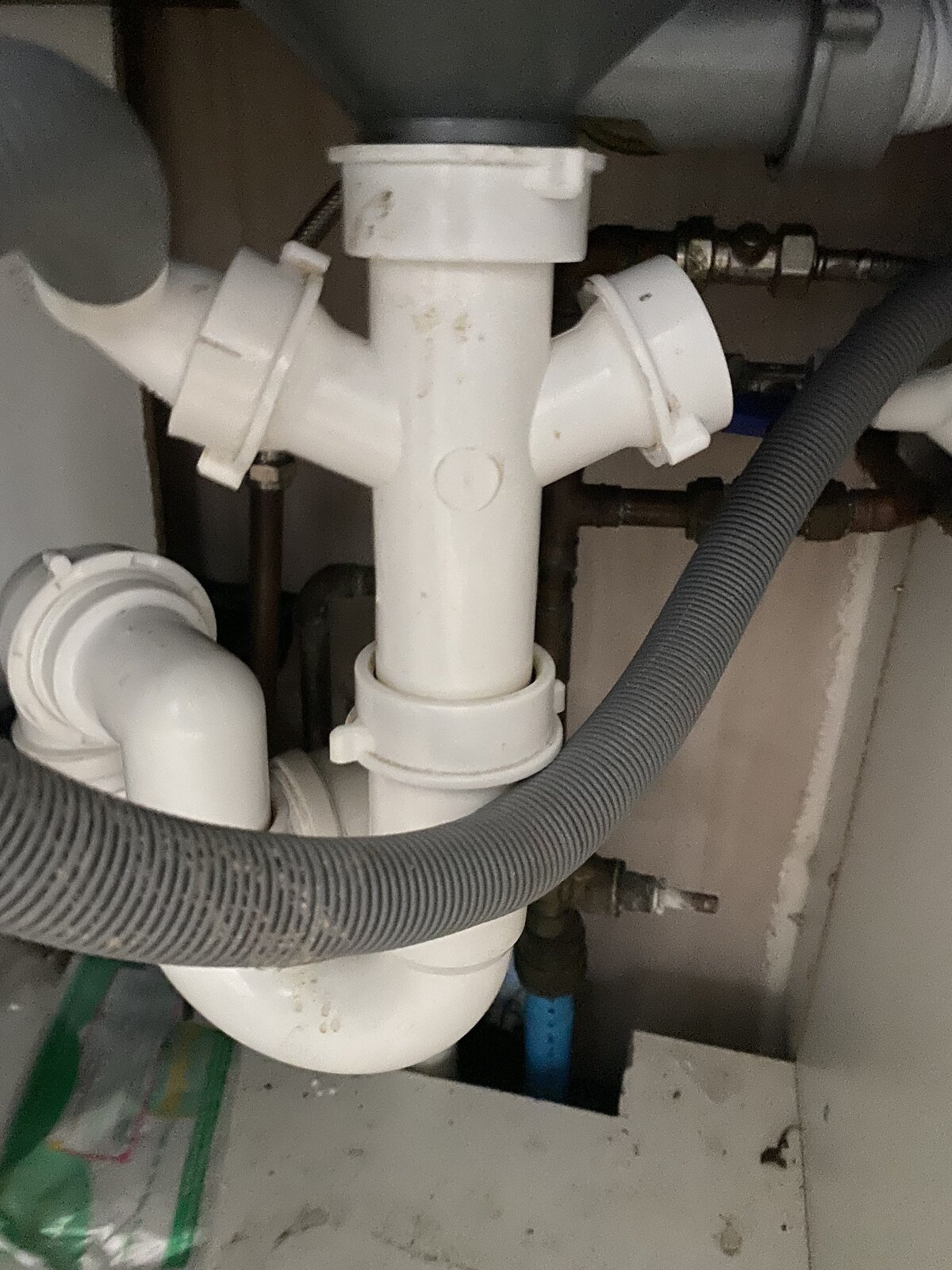

Fit a new trap with 2 spigots. Manufacturers don't all use the same threads on spigots . Unless you know the manufacturer of yours ,and even then you might not find anyone who stocks their spigot , your wasting your time.
  • Like
Reactions: CBW
Are all sing plug dimensions the same? It’s only the pipe that the new trap connects to that may be different?
The trap , connects to the sink waste,and they are 40mm traps. Unless you have a European waste fitting ,the thread sizes in UK are industry standard.
The waste pipework where it meets the new trap may need adjusting to align them .
