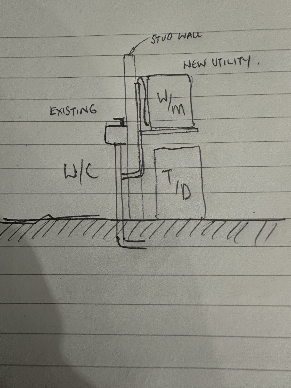

We are thinking of using our study which is next to the downstairs WC as a utility room. This would feature a stacked washer and dryer backing into the wall which contains the water supply and near to the sink drains.
I’ve seen a few posts not recommending sink drains due to the lack of a stand pipe etc, but our current washer is just plumbed into the kitchen sink drains and isn’t even that high.
If the washer was at the top and the drain went up and into the stand pipe, then down and through the wall into the WC sink drains. Would that be a reasonable solution?
Diagram attached.
IMO you will regret placing the washer over the tumbler. What about fitting an appliance trap to the sink and then connecting the washer's drain into that? If the link times-out, then search Product Code: 85397 at Toolstation.
Washing machines are incredibly heavy, and vibrate considerably when on the spin cycle. The noise, and vibration, mounted on a wall would be tremendous.
Yep - thanks both. Not thinking in the heat.

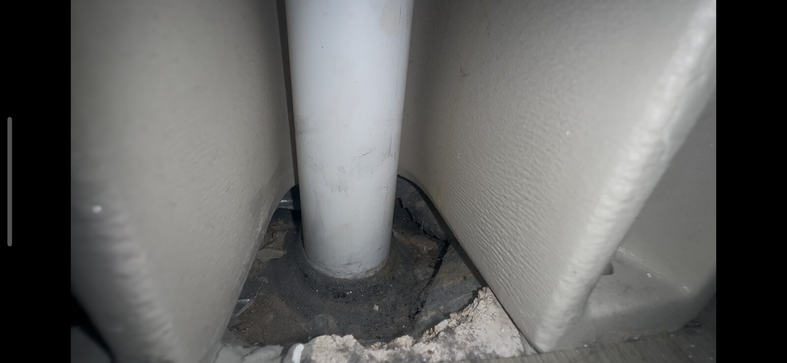

Update: pic attached showing waste pipe and hole in floor…

Pic above appears to be a reducer Cap on top of the drain, to allow the original installers to connect the basin directly to the drain. It's probably going to be a faff, but it you can get that off, you should be able to replace with one offering a 40mm connection, or if you're really lucky, it may stretch enough to allow a 40mm waste pipe to be inserted in lieu of the current 32mm.
Had a look at the photos I took pre-plaster (wish I’d taken more) and I think the 10mm feeds for the tap will be on a tee piece reducer from 15mm. Assuming that tee piece is in the ceiling it’s an option to open up and feed a need 15mm feed to the washer.
For the waste, yes I never realised how open it was behind the pedestal. As I said I’m thinking of fitting a unit there so could easily open up the hole a little to fit a different reducer and then have the washer hockey stick feeding the new 40mm waste through the wall?
