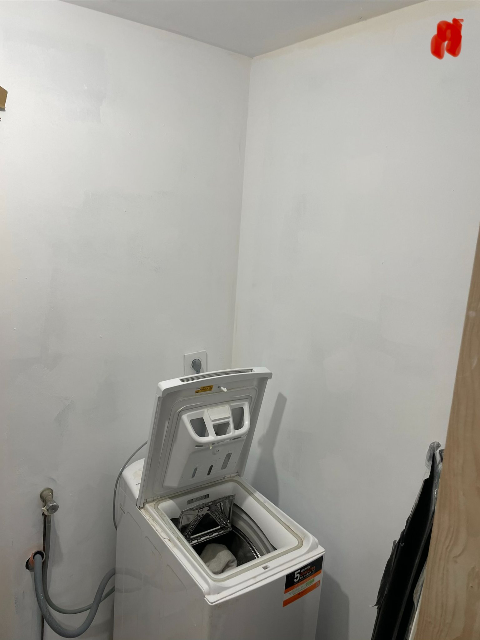

Hi guys,
I'm installing a shower with 40mm waste pipe in room above the photo. The pipe will come down from room above where the red dot is. I'm looking to attach the waste to where you see the washing machine waste as this is my only access to a nearby waste. My question is does the fall have to be very gradual all along the walls or can I do gradual on one wall and vertical drop to attach to the waste on the other? I'm not bothered about hiding this waste pipe as its all in a utility room. Thanks!!
Fred
Waste descends vertically by 25 mm for every 1m
