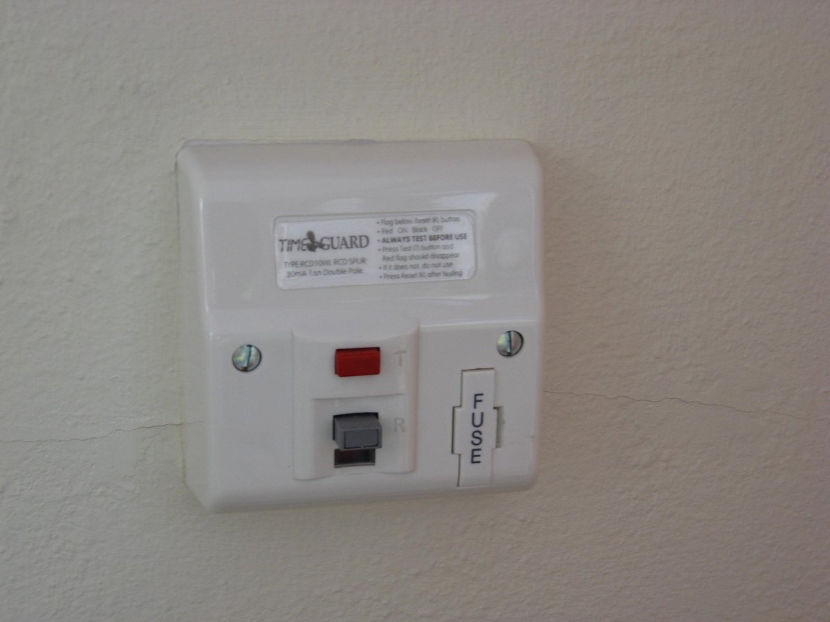

I posted my original question in General DIY re a new pond pump but maybe I should have tried electrics. I am having trouble with my garden pond pump. I am puzzled because I have a RCD (?) in the conservatory leading to twin sockets outside for the pump and filter. When I plug these two in the outside sockets, they trip the RCD. But, if I run the pump and filter on an extension lead from a socket in my house, they both work. I am told by an electrician that there is nothing wrong with the sockets outside or the RCD. He thinks the filter still works with the RCD but that a fault in the pump may be causing the little RCD to trip. I really don't know which way to go, get another electrician in or buy a new pump. The pump is 15 years old. Can anyone please advise which way I should go? Many thanks for any help.

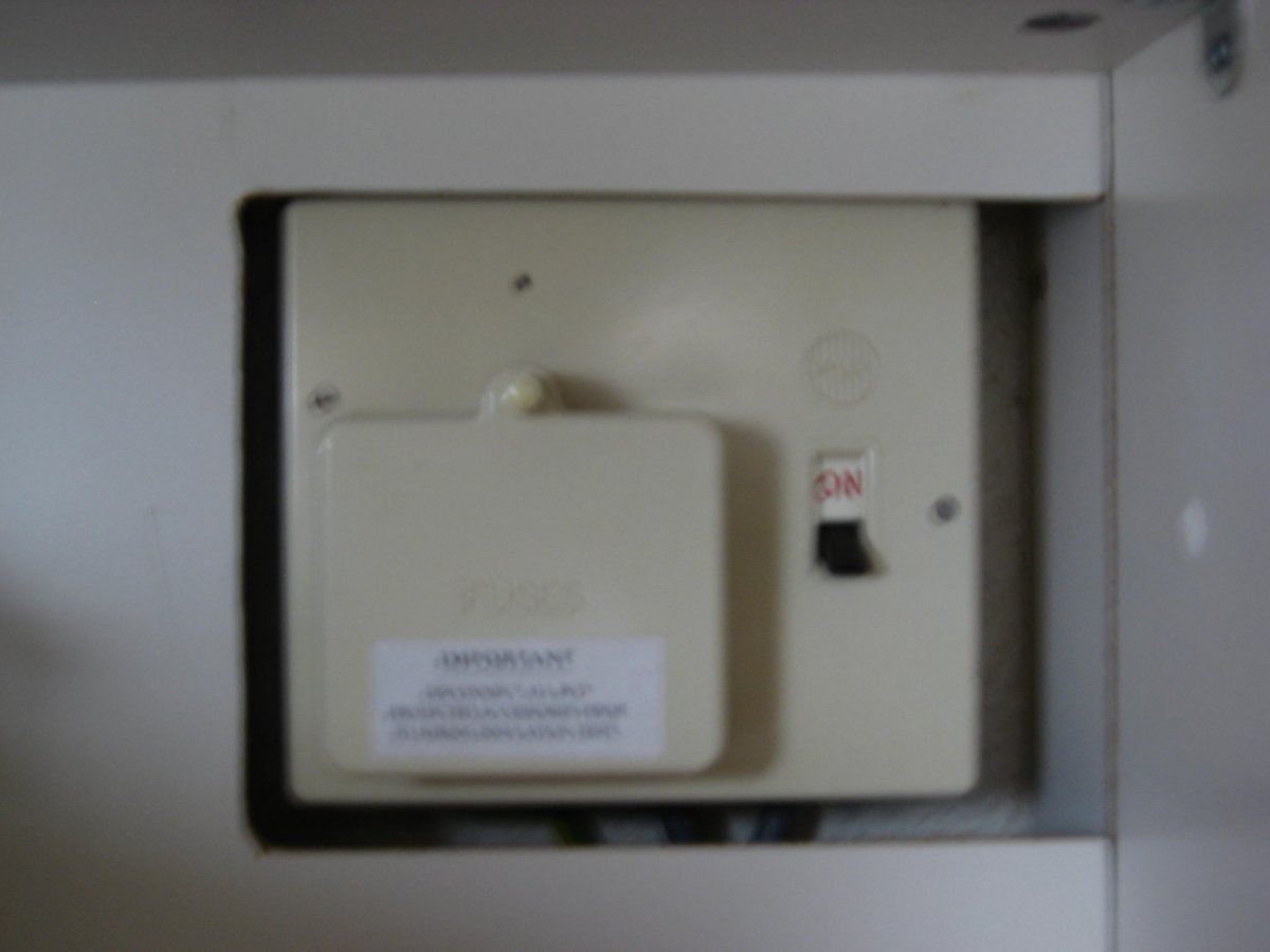

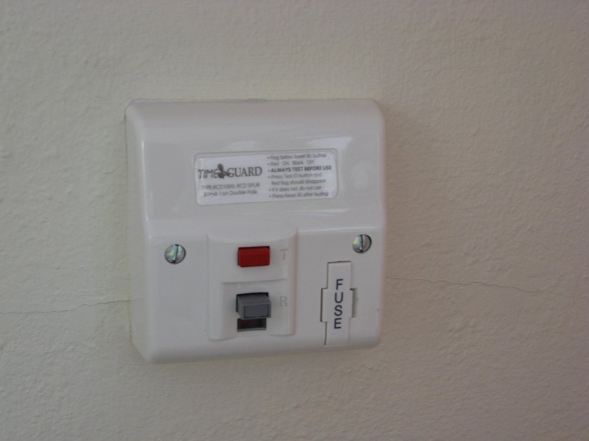

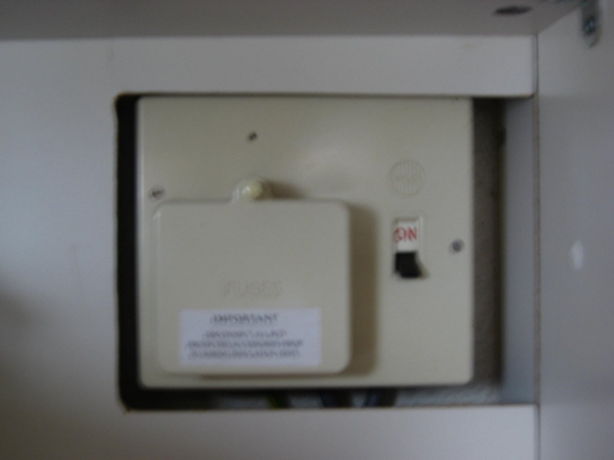

Post a photo of the conservatory RCD and also the main fusebox/consumer unit in the house.
Photos attached. Hope they are OK.

I just reset the RCD and both outside sockets worked with a hair dryer. When I put the two pond plugs back in they didn't work. Thank you for your help.
You don't have an RCD covering he house sockets that is why the pump worked on the extension lead. The pump is faulty and needs to be replaced, the RCD is doing its job and keeping you safe. You said above that you have two pond plugs yet you only talk about one pump, what is the second plug for?
The water from the pump goes through a Bioforce separate filter (with UVC light) outside the pond which is run from the second plug. Thank you for your help, I will get a new pump.
