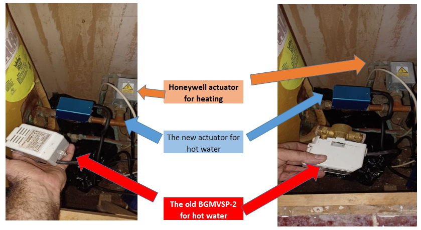

Hi Guys,
I would like to ensure that the plumber has installed the correct actuator for zone valve before I start working on the system.

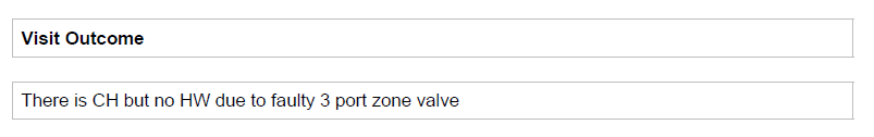

Please find attached the picture the old and new zone valve and the actuator. Also, in the report it is clearly stated that the engineer identified "faulty 3 zone valve" despite BGMVSP-2 is for 2 port. what if the new actuator (blue color) is actually for 3 zone valve, does if affect the flow performance of water from the boiler to the cylinder tank?
I appreciate your kind view and sharing expertise.
Kam

The above, only opens/closes to control the temperature of the HW, not its flow rate, which has allready been pointed out.
Thanks John.
In the link below, the maximum temperature for Honeywell Home V4073A Motorised 3 Port Mid Position Valve 22mm V4073A1039 is 50C
Where BGMVSP-2 can operate up to 95C
Does the maximum operating temperature affect the open/close the valve or the rate of water flow from the boiler to cylinder?
Kam
It doesn't matter whether it does or not as that water flow is through the heating coil and returns to the boiler, it has nothing to do with the domestic hot water flow from the cylinder.
