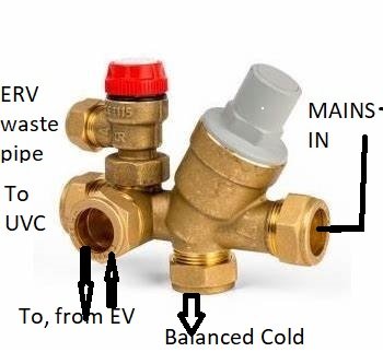

It's possible Xover from cold to hot, is the (balanced) cold supply taken off the unvented cylinder valve set like below??.
Good morning Johntheo5.
Thank you for replying. A valve such as that is installed and with the mains connected as your picture. There looks to be several connections from the outgoing side with one of them going to the cylinder. It has the expected 3bar marking on the valve which I believe is pre set by Telford cylinders. ( cold main inlet control group).
Can you shut off the mains cold into the unvented cylinder, should be a lever valve upstream of that valve group and then confirm that there is no cold water coming from any of the taps.

I shut off the incoming mains cold to the cylinder and all sinks in the house stopped running cold water. So I am assuming that the control group is maintaining 3bar pressure for both hot and cold to the house ?.
