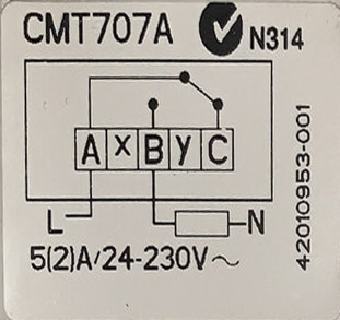

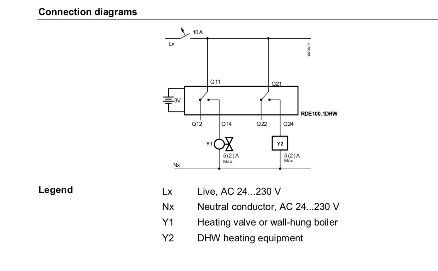

I thought I’d asked this before, but I can’t seem to locate the thread.
Why is it that certain manufacturer’s state a switched live as a neutral conductor, instead of stating switched output/live, or, is this my poor interpretation? (Examples below)
Is it that with all intents and purposes, that it eventually connects to neutral? :oops:

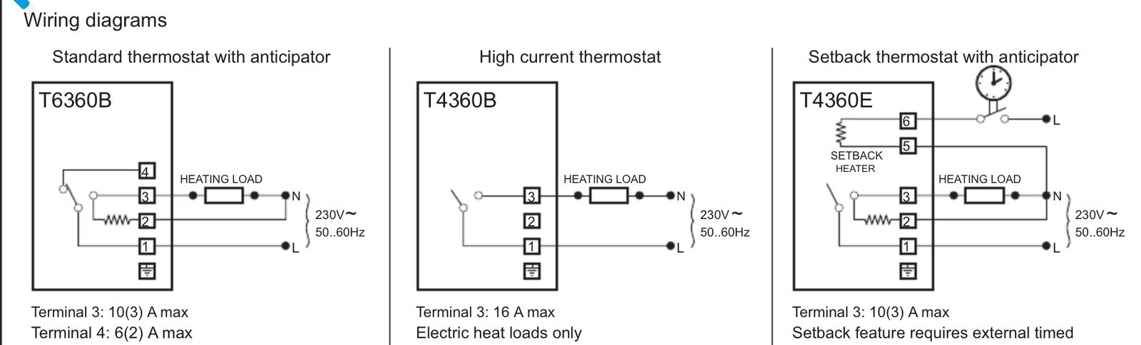

They don't actually state that the SL is Neutral because the rectangle (or other symbols) represents the appliance (load).
This, I am sure, is not clear to DIYers.
  • Thanks
Reactions: CBW
It would help to add a label for the connection that is the Switched Live.
When the switch is OFF then the Switched Live conductor does provide a path to Neutral via the load but it is NOT Neutral. Some equipment takes advantage of this by using the Switched Live conductor to provide a Pseudo Neutral to supply power to the electronics in the switch / thermostat / whatever,

set of diagrams of the three shown is fixed to a 230 volt supply as the anti-hysteresis heater and setback heater need 230 volt to work.

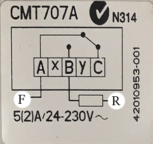

So which will most people understand upload_2022-3-14_10-56-27.png or upload_2022-3-14_10-59-53.png for feed and return? I would say for a universal label when you don't know if using a mains 230 low voltage supply or a power supply with a 24 volt separated extra low voltage supply then L and N are better than F and R or L1 and L2.

Each load has two connections one is always a permanent live or a switched live, the other being Neutral as shown
So it is basically connected to the neutral somewhere along the way?
I am proberly not the best at explaining things.
Think of a basic lightbulb it has a Live and a Neutral to function , only divided and connected by the actual filament.
Your stat drawings can be used for various loads, fans, heaters, lights, hence they use a Rectangle symbol for the load, maybe replace that symbol with a light bulb and may help you understand a bit better.

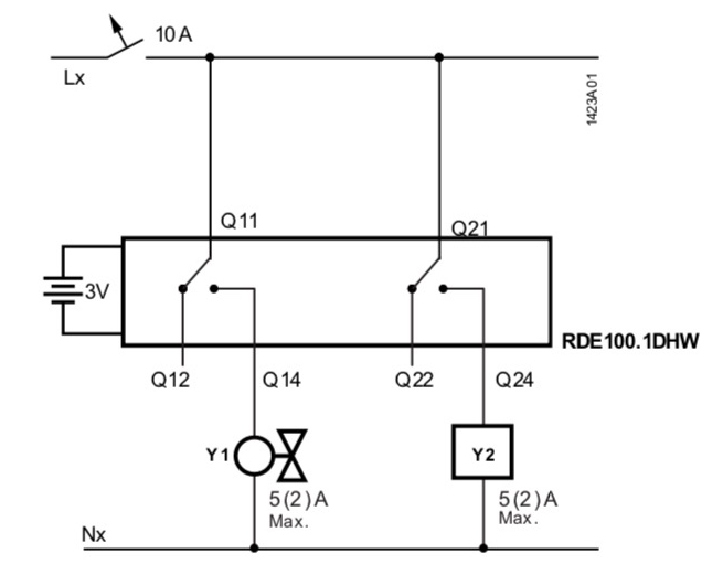

upload_2022-3-14_14-54-44.png The wiring diagram without reading the key would make me think Y1 is the circulating pump and Y2 the boiler, as used with a typical C Plan central heating, clearly the same relay can be used for many other things, the instructions does show examples upload_2022-3-14_15-2-47.png on how the unit is used, so no real problem.
