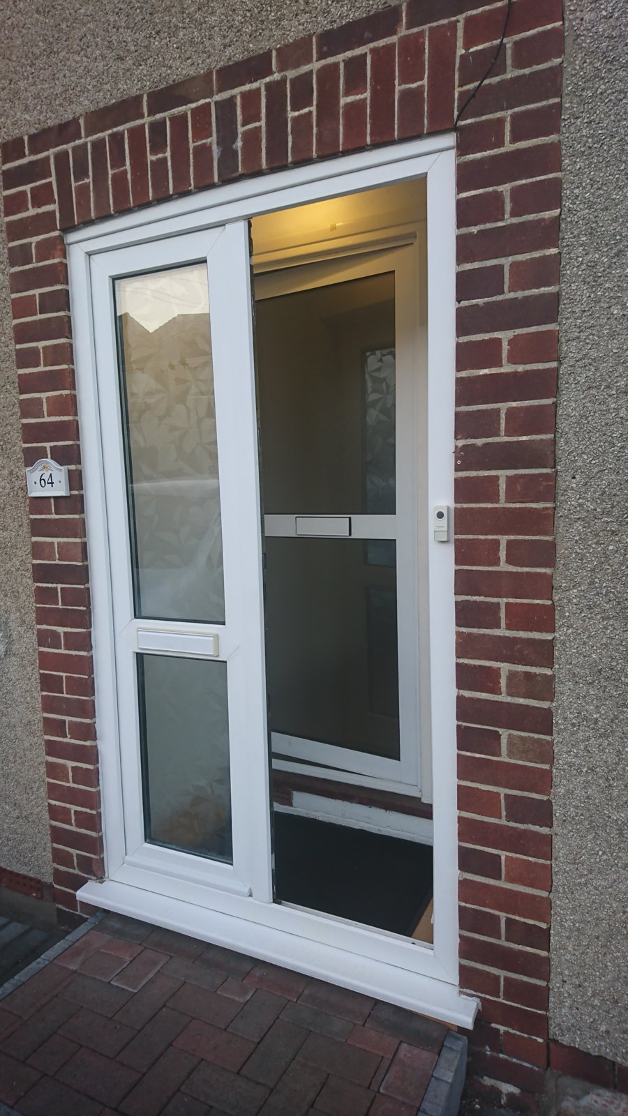

1950s solid brick build house with a front porch that has a UPVC door install 20 years ago but old internal door is in place still. Its very cold, no insulation on the porch part, air bricks circulate air into the porch so looking at options to insulate. Converting to part of the hallway seems the best option and remove the 2nd front door. The old internal door and windows (single panel) with some wood are ineffective....
What permissions do I need to make this small internal porch part of the hallway ?
The air bricks work but only into the porch so limited use. I checked under the floor boards in that corner and all very dry and drafty! Can I close them off or should I redirect to the true front of the house ?
I do not know if you are ok to remove the original front door but suspect that it is fine . However, you probably need to refit the porch door to meet insulation standards . Plus raise the floor to match the rest of the house.
Personally I wouldn't bother as a porch is very useful and acts as both insulation and a wet store for brolly's and bolts etc
Thanks. The porch is only 50cm wide, its pretty useless for storing anything in, annoying to get thru the two offset doors and with the airbricks into the porch its not insulating much. As it it has the same insulation as the hallway i.e. none as solid brick.
I'm not sure what else to do with it to make it useful and warm other than make it part of the hallway.

Solid one brick insulates reasonably well, certainly relative to a tent. Two solid brick walls would actually be a lot better than one.
However that's indeed no reason to keep a porch that doesn't work.
Apart from building regs you'll also note that security is often better with two locked doors than one.
Plenty of people don't bother with building regs for this kind of thing (, usually opening up conservatories rather than porches) but it's usually picked up at sale time even if the first owner is prepared to put up with it.

Officially, it needs regs as it becomes a compliant structure as not thermally separated.
Unofficially, its hardly the crime of the century!
Be careful the single walls dont suffer condensation -try removing the door for a few days in winter and see how it is.
