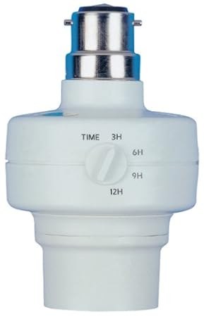

Im sure i once see a lamp that comes on at dusk for a preset time only
If theres room in the fitting there is these
https://www.amazon.co.uk/Smiths-Guard-Holder-Random-Switch/dp/B001GJSAWE
