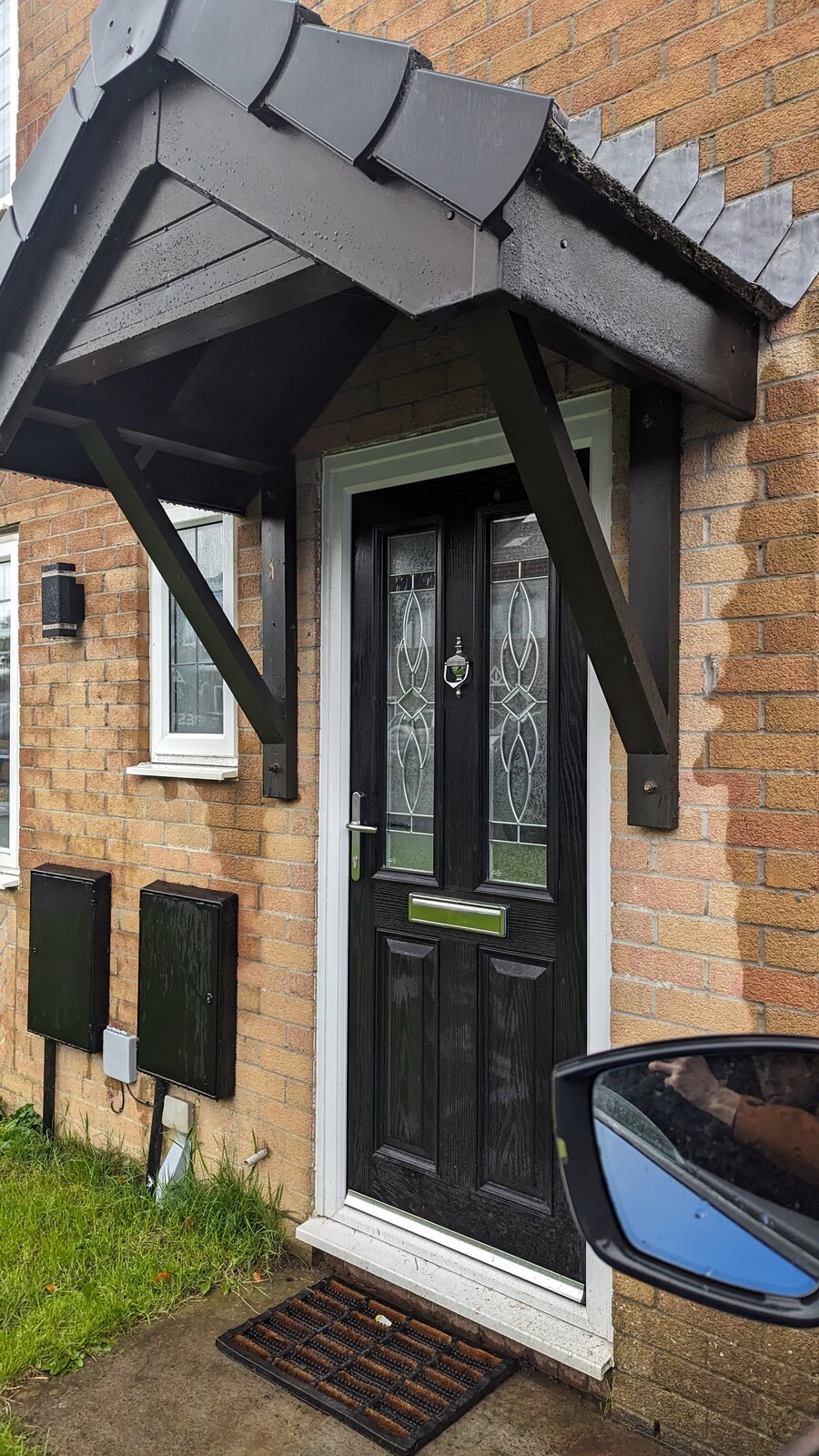

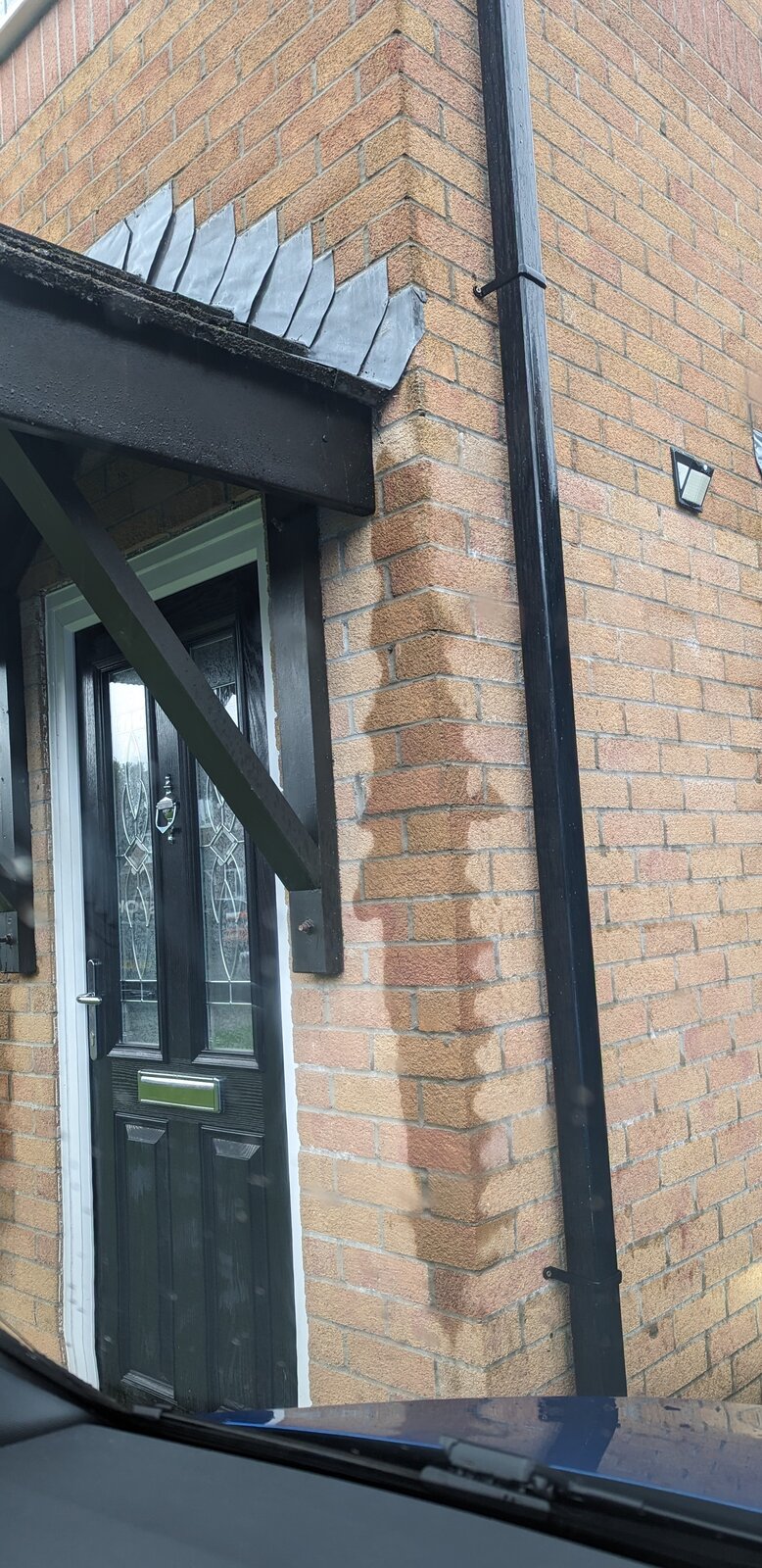

Morning, I've noticed this morning wet brickwork outside the front of our house. Seems to be coming from the porch roof.
Could be a coincidence but I did clean up a decent amount of moss from the porch tiles on Friday.
Any ideas? Got some of the left side as well but not as bad
Pics below, thank you

Its run off from the porch.
wind direction prprobably - if the wind blows rain against the house wall it will run down until it hits the porch roof and be directed towards the brickwork.
if you are bothered you could put a gutter in that side as you’ve a downpipe close by
Thanks. We've only been here 7 weeks but still strange how only noticed it today as it's rained a lot. I wondered if the moss I removed had somehow been helping collect water lol
The moss might’ve slowed run off, now with a clean roof it’s probably shooting off
I would say it’s not a problem because if it was the house brickwork would’ve started to go a bit black in those areas
Is there anything I could add to the lower section of tiles to stop water running off as quick. A small block of some kind which would help slow it down or possibly route to the middle of the roof rather that wall? I'll be sticking the moss back on at this rate
If not, I'll see if it happens a lot more now the roof is cleaner and if so consider a gutter

Is that section of wall below the first floor windows saturated, as there is a markedly different colour to those bricks below? And likewise around those ground floor windows to the left.
To be honest I think it's just very strange lighting from the camera. The bricks may have been slightly damp from rain direction but both pictures make it seem like different colour bricks, which isn't the case
They look saturated, and there is an algae stain up the corner.
Anyway, there would be a cavity tray in the wall above the canopy, and if that wall did get soaked, that water either side would be in the place were the water would be exiting the cavity trays. It's a possible alternative, to the driven rain theory, as it does show as similar staining.
This hasn't happened since my initial post and it's been torrential recently. I guess it was wind causing it
