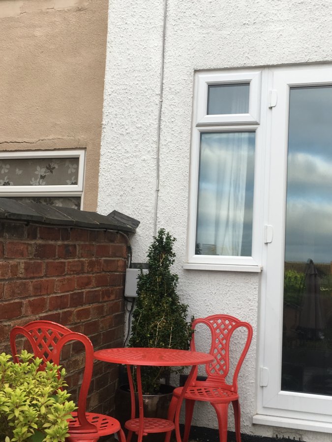

Hi all,
Most of my vicorian house has been pebble dashed and painted white ... however there are two gable walls that have got that sharp render stuff you put on with a roller ( think its called tyrolean ?? ) .... anyway the rest of the house is fine but one of these walls has penetrating damp.
There are no obvious cracks or lose areas so it must be porous.... I don't really want to paint until we paint the whole property ( big project ) as it will make the rest of the house look dirty.
Is there any clear product I can paint on to seal it up ?

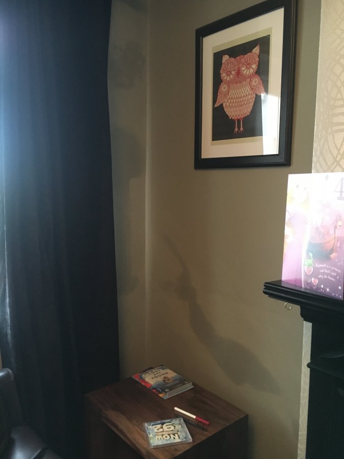

Why not post photos of the interior damp signs and the exterior side of the penetrations?
Inside outside pictures ....

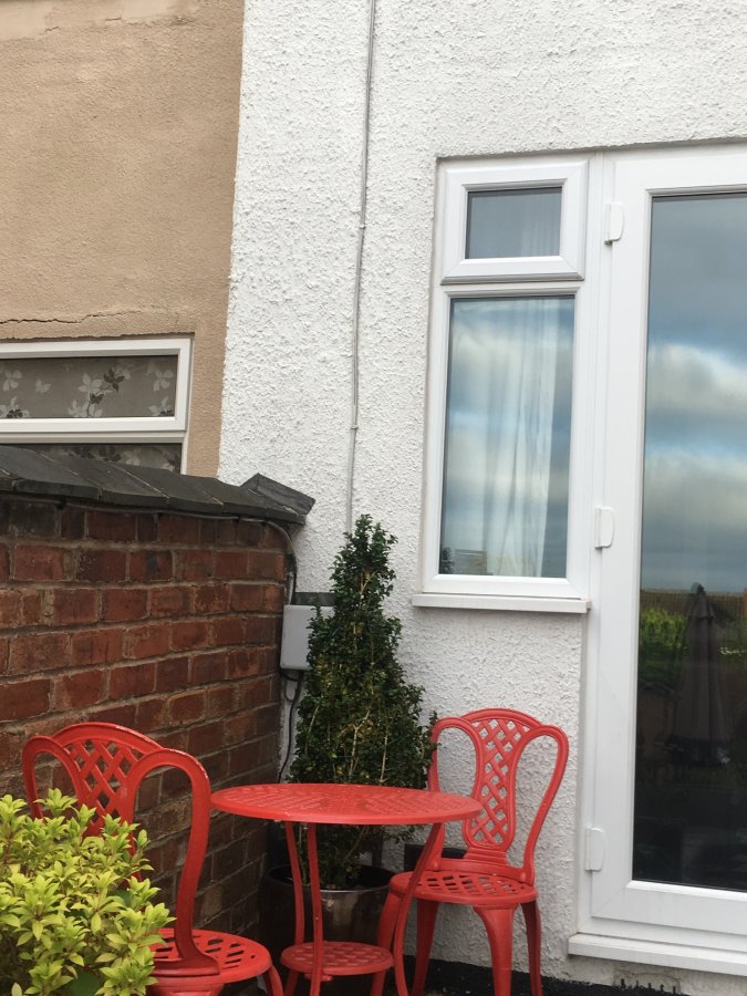

The garden wall is butting the rear elevation and possibly allowing penetrating damp to enter.

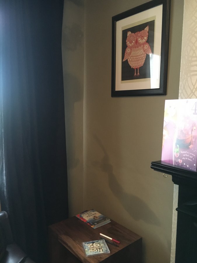

Its impossible for me to see whats happening in the room - bad light, furniture and the curtain restrict viewing.
Are there any signs of damp or salts on the chimney breast plaster?
Has anyone ever examined for rot, the joist tails in the rear wall, and round the c/breast trimming?
Your neighbour's raw looking render is obviously failing - exactly what is that mix?
Your render has an indentation, and no drip or bell cast above your frame?
The damp is the dark patches ...there's no sign of damp around the inside of the window reveals.
No the chimney breast is fine
Yes I've been under the floor, the joists are fine ...

Theirs is tragic all over the house .. its in a very bad way tbh but not my problem and I can't see it being related as the houses aren't joined.
There is an 6 inch gap between our property and there's
None of the windows have drips or bells .. this is the only wall with a problem.
The garden wall has always been there .... this is a new problem over the last 6 months.
Have a look at the photo of next doors window..There seems to be a big crack over the window,this will be letting water in both properties. It also looks like there maybe more cracks above that window...
Thanks Roy .... The properties aren't linked ... There's a 6inch gap between the houses
