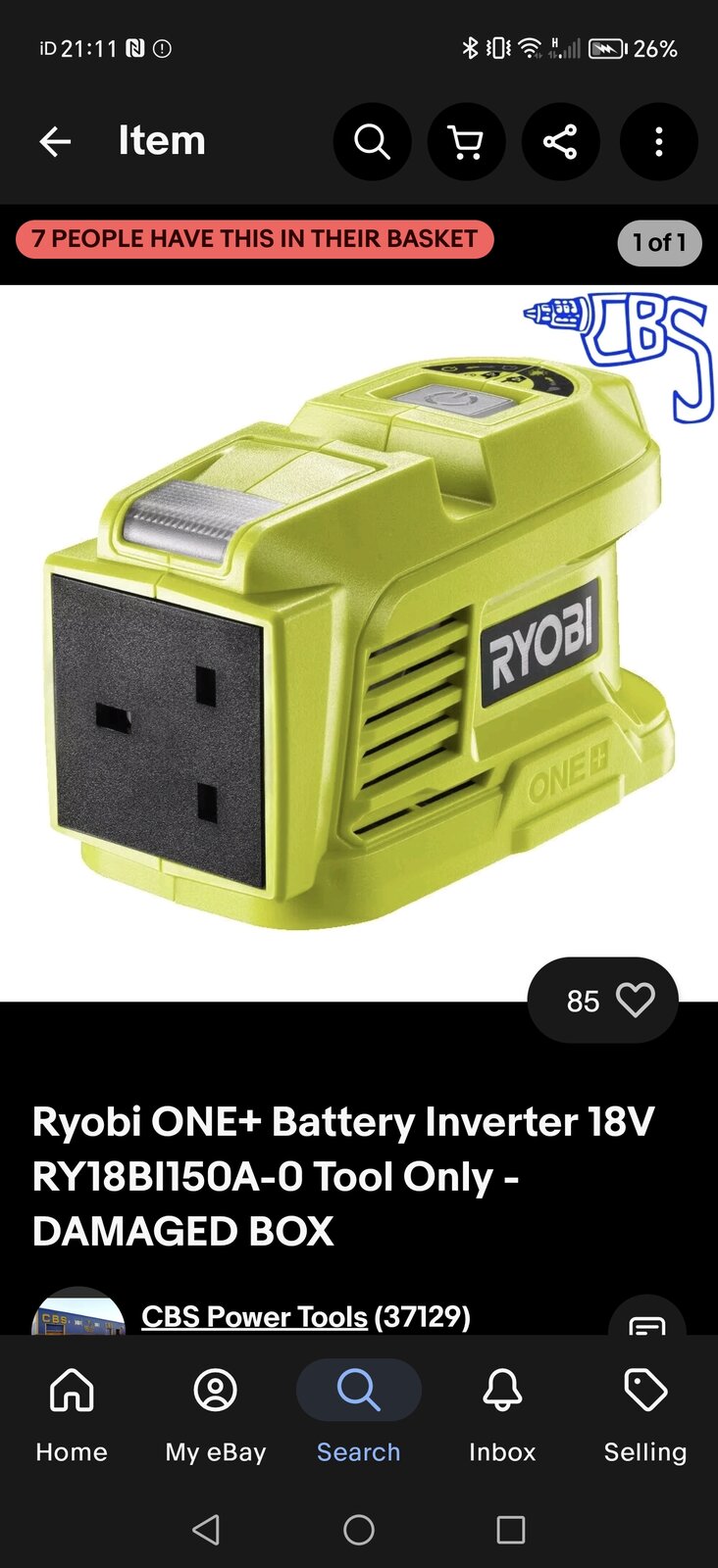

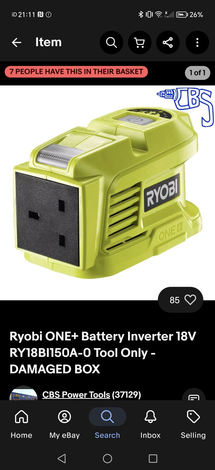

I was thinking of something like this at first, but I know nothing

That Ryobi inverter has a max out of 150 W so would be completely unsuited to the 800 Watt load!

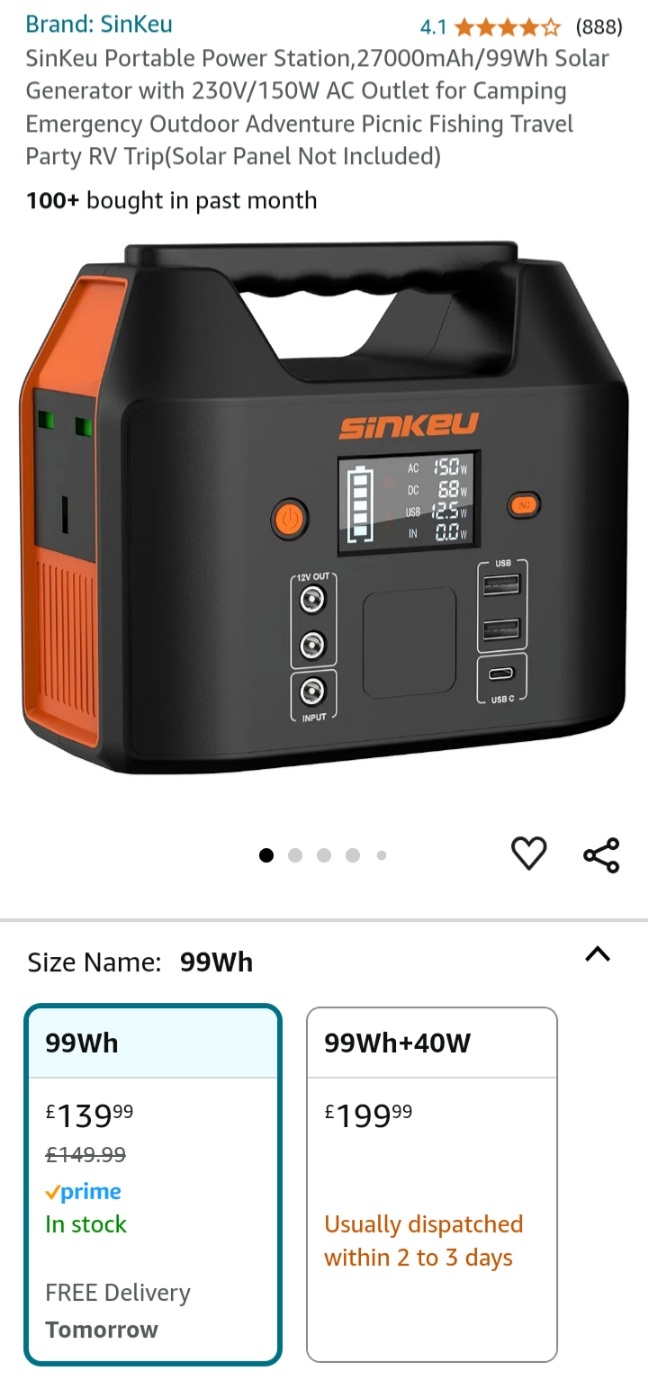

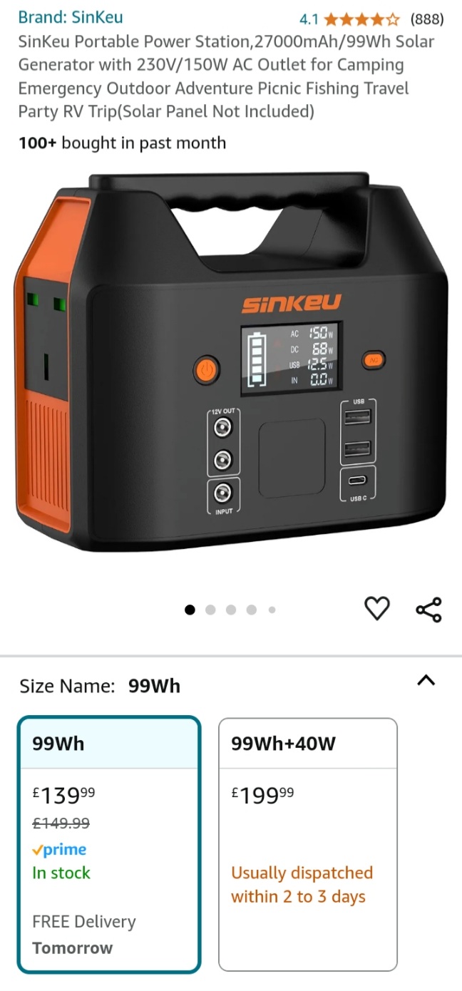

A 12V, 1.5A PSU, at most will consume 18W.
The actual figure will be far lower.
Say for example, we guess at 15W (still a huge overestimate) and you want it to run for 10 hours, we would want a 150Wh battery bank.
The item Flameport links to in #13 is 230Wh and would be perfect. There may also be capacity left over for the rotisserie.
If you wish to specify your own powerbank, a unit with a capacity closer to 150Wh would be cheaper.
However the specs can be confusing - for example, an item from Amazon..
lists 27000mAh/99Wh with a 150W output.
The mAh rating relates to the internal 3.7V lithium battery capacity: 27000mAh = 27Ah
27Ah x 3.7V = 99Wh
Often, however, the more useful Wh rating is left out of the listing.
The 150W output rating, relates to the maximum power the bank can output consistently, until the battery drains.
So at the maximum load of 150W, this 99Wh power bank would drain in 40 minutes!
I hope that makes some sense! :)
