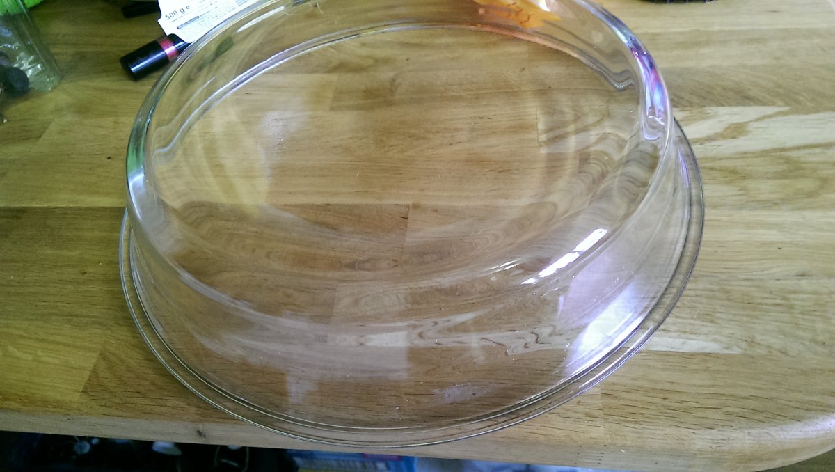

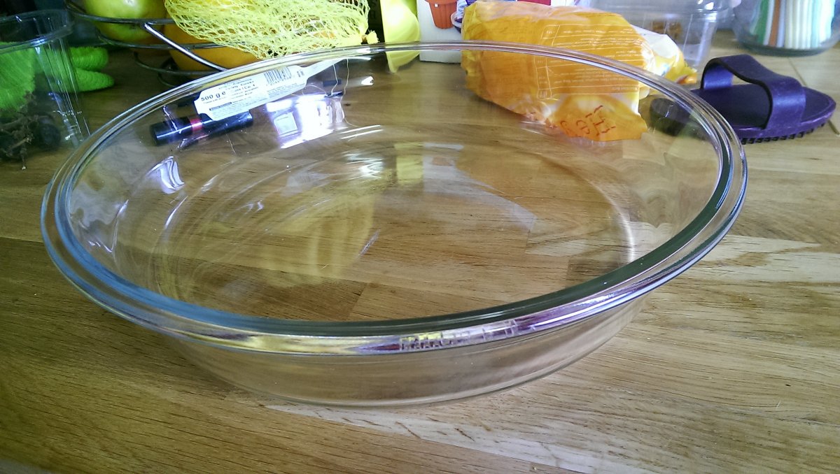

Hi all, I have a couple of tumble dryer glass pieces I want to mount as porthokes in wooden shed wall. Has anyone got an idea how to do this.
Ah yes, the details. Sorry, just trying to get my head round it.
Just glass fixed will be fine, and easier I guess. At the moment I am thinking of just cutting two thin ply skirts to sandwhich edges, with maybe blocks in middle to keep straight. If that makes any sense.
Have made this, they will go in space on left.
Fixed. Shut, no need to open, just porthole for kids to look out of. Bowl out, like when you go to aquarium and kids stick their head in bowl.

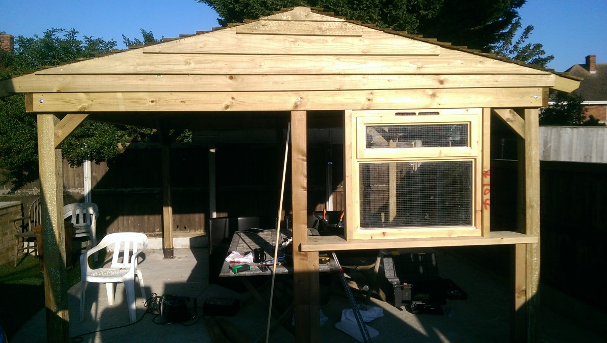

Will clear silicon it in, but the shelter is not totally watertight anyway, it is just to keep the sun, rain etc of hydro tub so will be partly exposed, with concrete floor.
The roof is just shiplap, which I know is not recommended on its own but a few drip in the tub is worth the view of natural wood instead of ply sheets or similar and low cost.

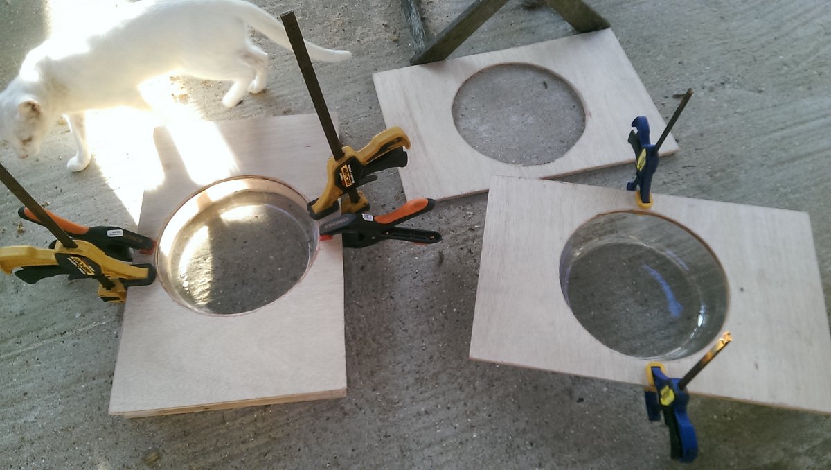

I have routed four of these 9mm ply so far, sticking with silicon on one side and sandwidging together.
I'm not so sure if it will work but looks good so far. Howether I now like the chunky wood and nautical bolt ideas.

ahh ok on the face rather than through with the rim internal but bowel external as i had assumed
no problems at all except all the fixings are now external where as my idea placed then on the inside
so most off my ideas will need adapting to allow for how its set up iff you use them
ok further reading you have both internal and external :rolleyes::D
9mm will be difficult to screw into but bolts and nuts will work :LOL:

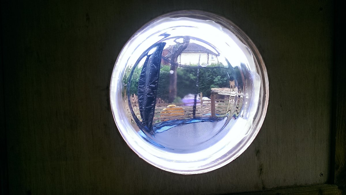

Well, here's first one done, my ideas are always fluid. Plan as I go, or finished sometimes.
I'm going to look out for some old ship odds to decorate bells, thick rope, anchors etc. Want a wheel for kids to play with as well.
