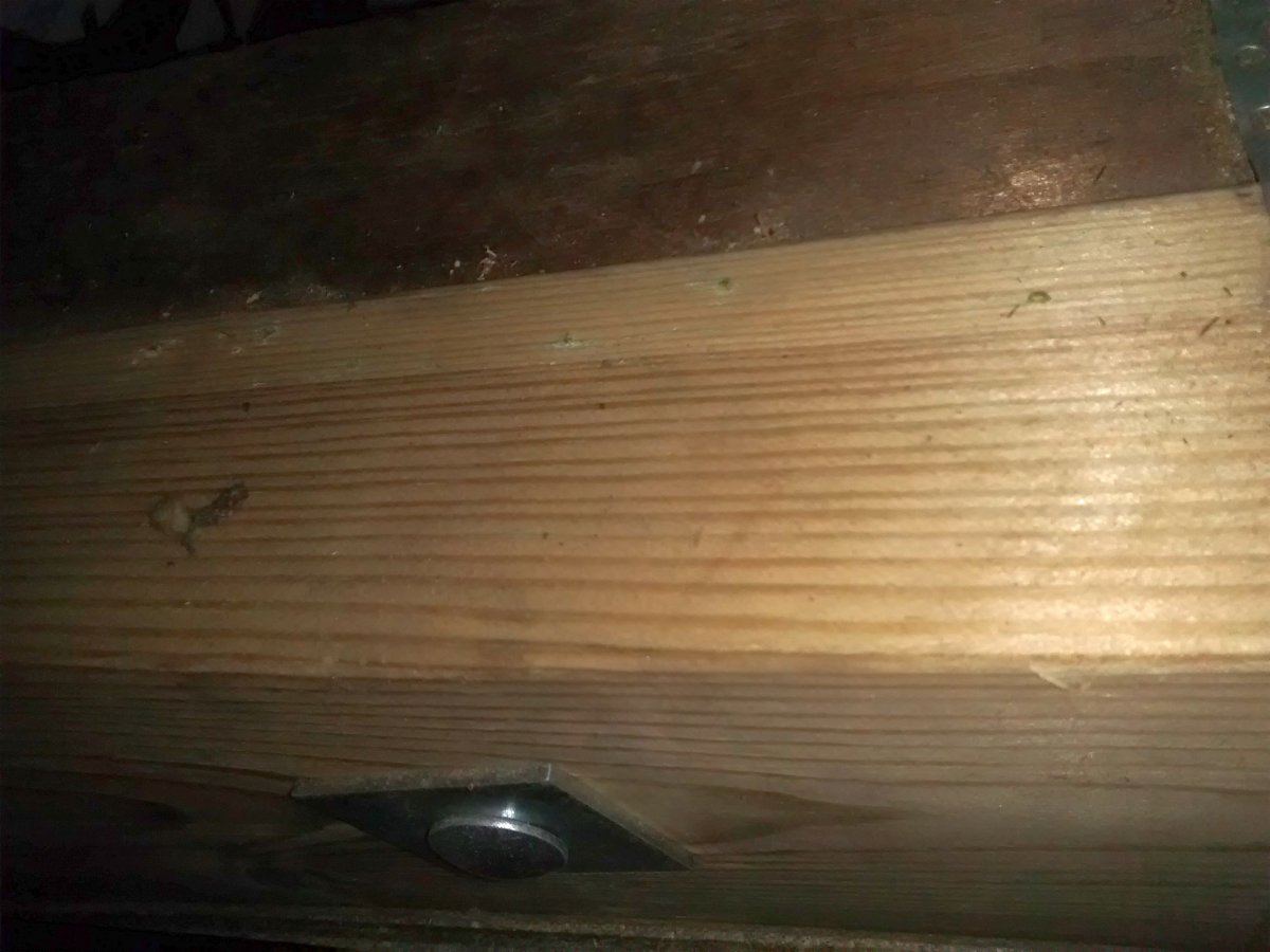

all the new joist are 6x2 cl 16 graded span is 2.3m on one side of loft and 2.4m and other side of the loft , both resting on internal load bearing walls on one side and fixed to the 9x3 beam on the other side with joist hangers.
The spacing between the the joists is the same as the old ceiling rafters 400mm,
9x3 is cl15 / other is cl 24 graded which are spanned 4.5m , he has then bolted the aprox 8x4 binder together with m12 blots and squre washer to the back of the 9x3 , the binder are the same height has the 9x3 beam i.e inch or so off the old ceiling rafter and the binders are cemented to the wall on one side.
He said that he has connected old ceiling rafter to the 9x3 beams with metal building band to stop the ceiling bowing and he said also connected them to new 6x2 at same spot were the old binder was removed again to stop the ceiling from bowing.
our main concern was the could the 9x3 snap if we put too much load on it?

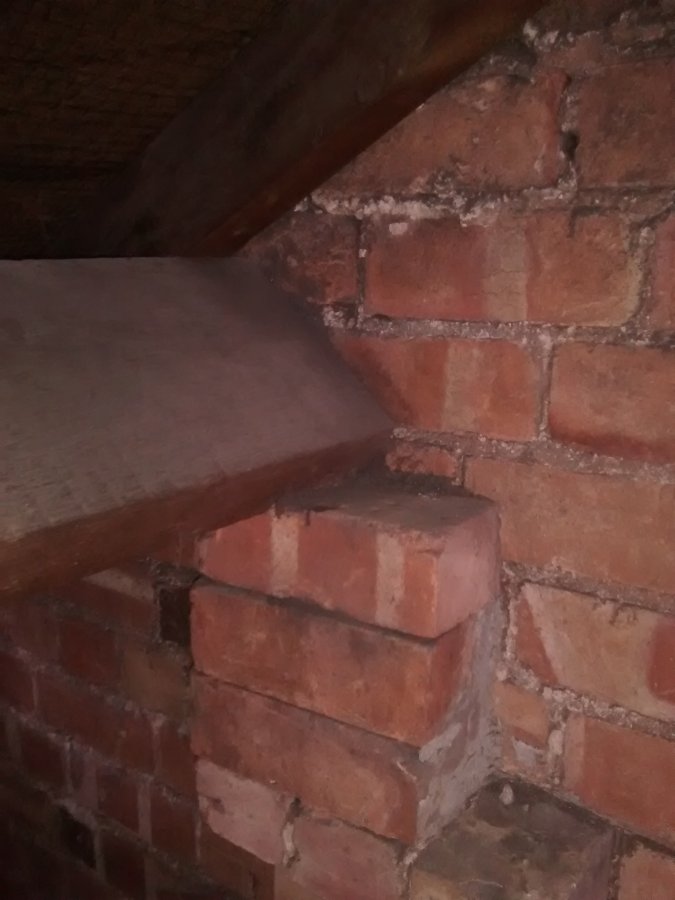

He has not touched any of the roof structure what so ever, he said the purlins are resting on brick support which are coming out from wall one side and chimney breast on the other side.
Nothing from the purlins was connected to the floor, he has suggested we have 4x2 collar tiles to tie the rafter at ridge, as he thinks sometime ago when roof was changed from slate to tiles but not extra support added.
He does not like the way the purlins are resting on the brickwork but he says thats how they built the houses back in Victorian times, any idea how he can make it stronger.
Nothing wrong with that - leave it alone.

How long is the purlin? I have no SE basis for saying it needs supporting, but I have done god knows how many loft conversions and can't remember any purlins over more than about 3m that haven't been supported mid span, what size and length are the roof rafters. Just because your man hasn't taken them out doesn't mean they shouldn't be there.
Purlins usually indicate roof rafters that would otherwise be insufficient to span the whole length of the roof and themselves unless of short dimension need a support of their own to prevent sagging.

Just a thought but but the OP mentioned a binder that had been bolted to the 9x3 was the same thickness but an inch smaller 8x3?), doesn't sound like any binder I have ever seen.
Purlin is about 4m , rafter size is 4 x 2 length is around approx 4m, binder is aprox 7 1/2 x 3 see pic
that's one serious binder, what size are the original ceiling ties, and where was this binder sat, was it along the spine wall.
