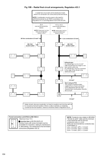

My mother's house is still on ye olde fusebox. It has four fuses - 2 x 5 amps for light circuits, a 30 amp for sockets ring and a 15 amp which I think is for cooker and/or immersion. The fuse box is under the stairs and she wants a double socket in the hall (no socket at present) - which would be easy to drill through bottom stair and run surface mounted cable along skirting.
Is it possible to add an extra socket on an individual radial circuit with this setup? If I got a spark into to do it, would he be able to add the extra socket, or will he insist on ripping out the fuses and putting in modern CU?
Thanks in advance for any advice.
Take a spur, from that circuit.
Thanks Harry. Do you mean spur from the socket ring circuit by joining into it where the fusebox is under the stairs? If this is possible/allowable it would be easy to run the cable out of a hole in bottom stair into the hall.
Wouldn't be practical to spur off the ring anywhere else in house as it would be quite destructive to get wires all the way to the hall.
NB. There is already one spur off of a socket in bedroom to feed a double in the garage. How many spurs are allowable on a ring?
Yes!

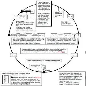

I had a ring final where all the sockets were on spurs, the ring went around a fridge, rather large, forklifts used inside it, it needed cleaning, so wanted an array of sockets for cleaning equipment, so a ring final using 6 mm² SWA was run around the roof of the fridge, with junction boxes where each socket was wanted, and spurs taken to each socket 10 foot down the wall, OK commercial not a domestic, but same rules apply.
These are the general rules.
