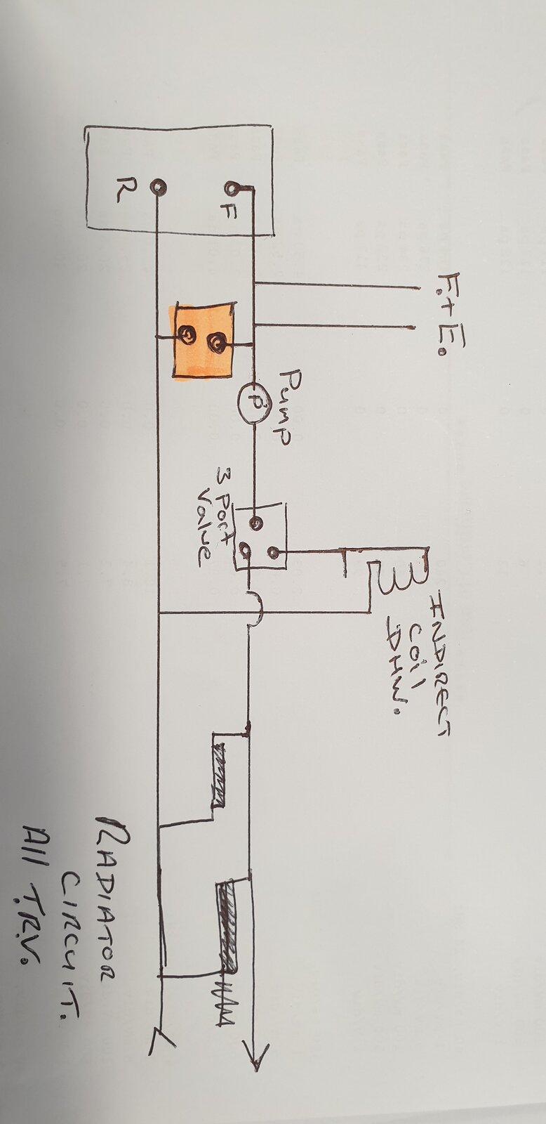

Ok Ive had chance to provide a drawing of my intended addition to the system .
As you can see the backboiler (orange area) will go in parallel with the boiler and the circulating pump will be controlled by a pipe thermostat near the woodburner , This will switch the pump on when the woodburner is lit. The Oil fired boiler will have the isolation switch off most of the time to conserve oil.

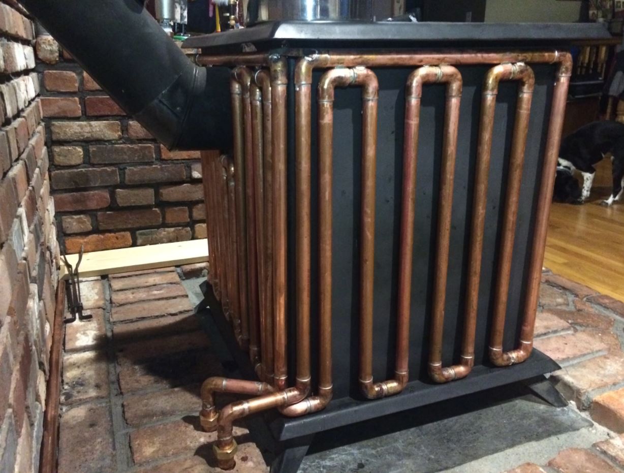

The new plan for the backboiler is to have a 22mm copper pipe matrix similar to the attached photo .
If anyone has any thoughts on the circuit i would be happy to hear them , just in case I have missed something. Thanks

As suggested ... You just need to ensure there are safety devices and a heat sump - constant flow - when using an uncontrolled heat source like a wood burner, especially if the system is to be sealed
Madrab,
Thanks for your input,
It will be an open vented system and am curious as to your term "safety device" are you referring to a pressure relief valve which would be beneficial in a sealed system. Yes, I could put a heat sink radiator in the circuit in case of pump/power failure.
Theres a lot of potential there for air locks I would have thought, you may have better results with buying or getting a baffle boiler made or having the loops run horizontal.
Yes that dawned on me earlier today.. I could change the design so to remove airlocks..
