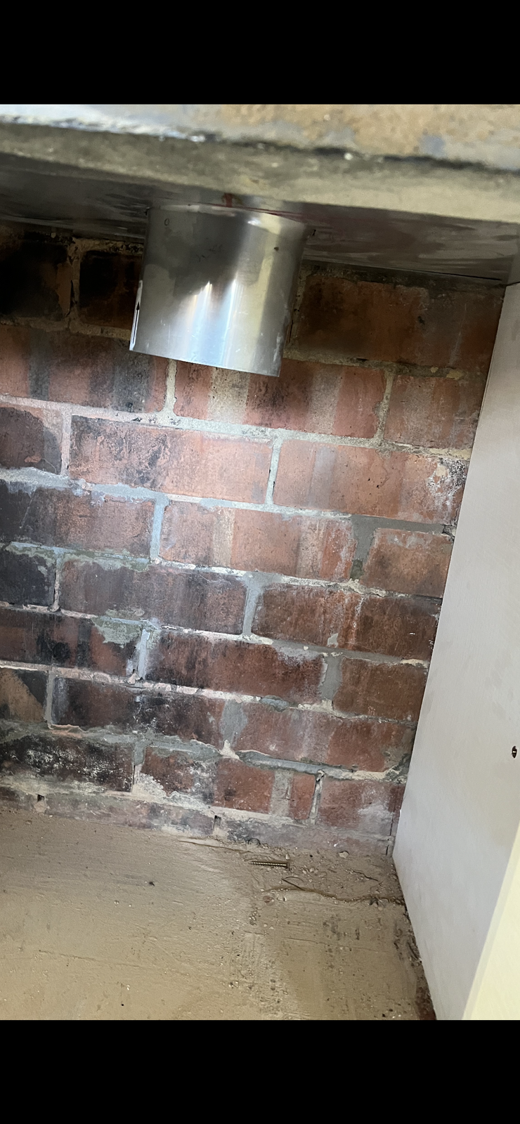

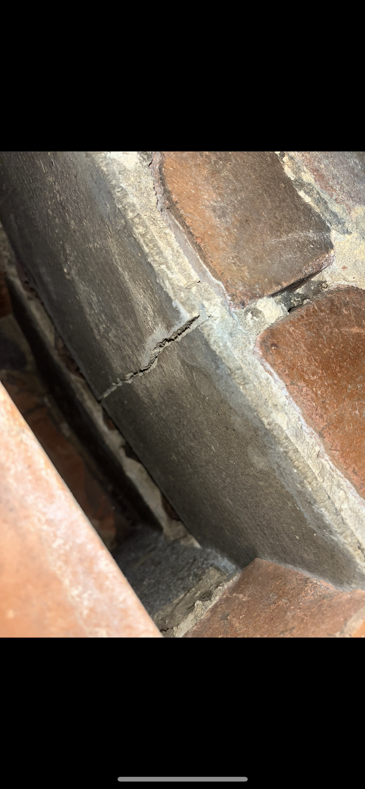

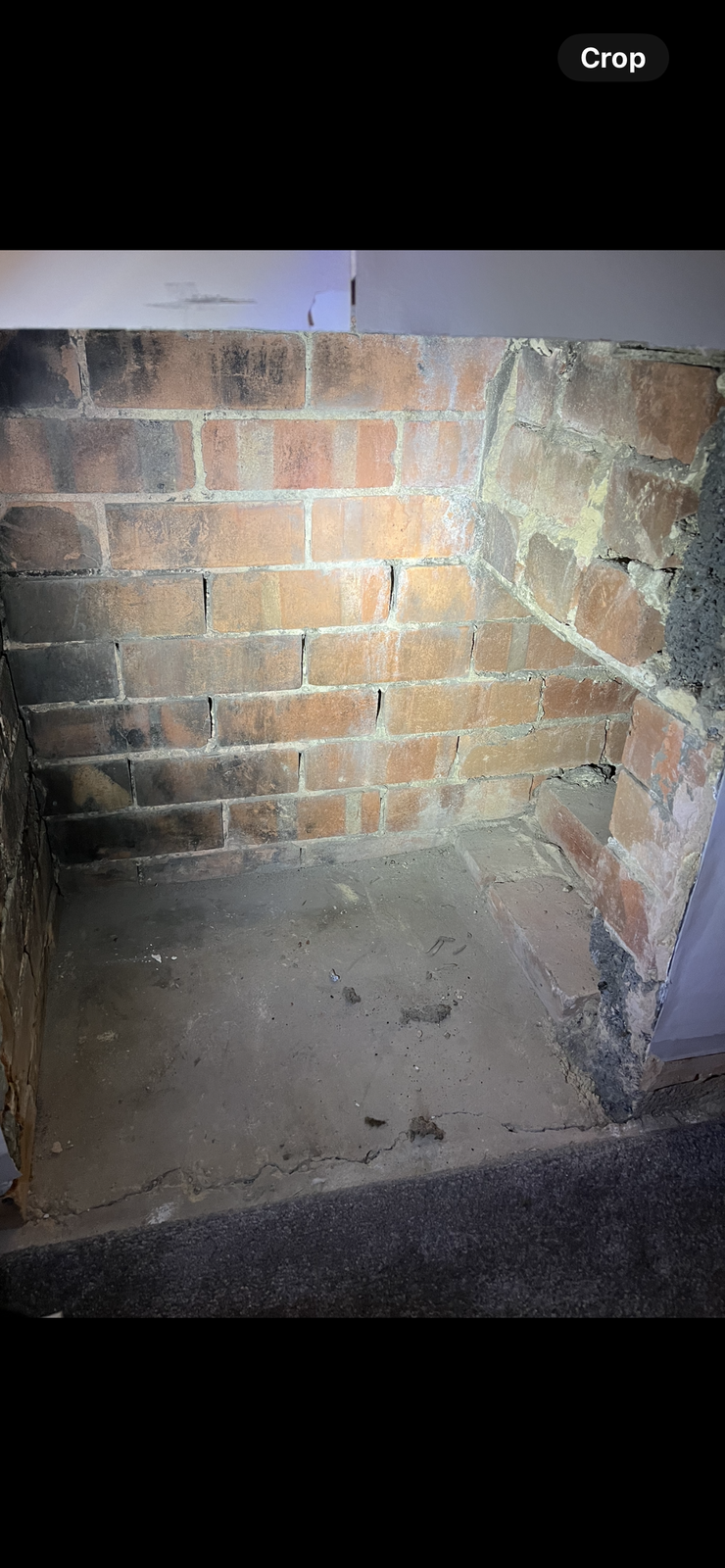

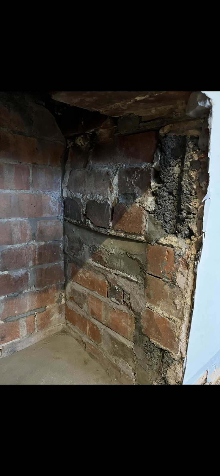

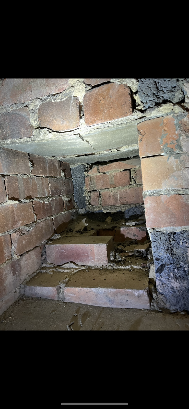

Hi there. I moved into a 1960s house (UK). As far as I’m aware, the previous owner used to have a gas fire, which they then removed. They blocked off the fireplace and boarded over it.
I had knocked through this to install a log burner. There are a couple of sheets that look to have been over what could have been a back boiler when the house was initially built. I did not think too much of it at the time but now of course in hindsight think these sheets could have been asbestos. Some were already cut and cracked (not by me).
If they are asbestos sheets, I can accept that I’ve likely inhaled some dust when knocking through/cleaning up the mess and there is nothing I can do about that now. However, I was wondering if anyone can help with the following questions please:
1. Does this look like asbestos? If so, AIB?
2. Now boarded off, is this likely to be an issue anymore?
I’m concerned more about if it’s an issue since I’ve boarded this off and the fact that I had hoovered up the mess and will have used that hoover all over the house since.
Any advice would be much appreciated.

All ok now boarded over and SEALED .
IF it is AIB you will now have contaminated the rest of your house by using the hoover . I have seen people having to dispose of all the soft furnishings and carpets of their house when things like this have happened basically anything that cant be wiped clean .
I would dump the hoover for starters just in case
Can't tell by looking. You can get an air test done and take it from there.
Waste of time.
Fibres - if present - will have settled, and to raise them (to give the test any validity) is against published HSE guidance.
To the OP: go to UKAS website - https://www.ukas.com/find-an-organisation/ - and find a local consultant.
Get them out, and talk to them face-to-face.
And, as Gas112 says, expect to buying a new vac.
Looks like asbestos cement to me going by the thickness and the slight dimpled effect on the rear section, rather than AIB.
You might want to dump the hoover but otherwise I would not worry too much I assume you took it out in more or less whole chunks, so very little risk I would think. (y)
Thank you. I was hoping not AIB. It was thin and grey as well, but I couldn’t find anything on line to show the difference between cement and AIB. Had not removed it, just boarded over and sealed around. Hoping that’s contained it.

It looks like cement board (chrysotile) so low content and lower risk than AIB.
