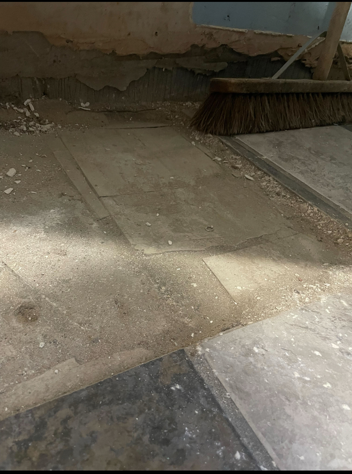

I have a lean-to utility room (extension to Victorian terrace, but has actually been there for a long long time) is being refurbished. There are ceramic tiles over a concrete floor.
I had an asbestos refurbishment survey done which lifted one of the ceramic tiles and found black adhesive but not vinyl tiles. The adhesive tested negative, all good. Today the builders started and took out some kitchen units. The ceramic tiles don’t go all the way under the units, and where they stop there are actually some vinyl tiles on top of the concrete. This can only be seen easily now the kitchen unit is gone - where the surveyor actually lifted the ceramic tiles it was just the adhesive left. Whether they should have looked under the unit is a different issue.
Question 1, and I know this can only be answered through testing - is it likely that the adhesive would not contain asbestos but the tiles could? Luckily the builders aren’t actually meant to be doing anything to the floor in terms of disturbing the tiles, but they are now exposed and looking a little worse for wear.
Question 2. The ceramic tiles are not in great shape but weren’t actually going to be replaced as part of this work. Now I have a situation where there are multiple levels in the flooring. I know that if they are asbestos they can be sealed and left in-situ, but how would you deal with the junction between the ceramic tiles and lower vinyl tiles? The finished floor doesn’t have to be perfect - there can be a mismatch in colour etc.. But I don’t want it to just fail at the junction of two different surfaces.

Here is the floor in question. Vinyl tiles were tested yesterday so will await those results. The area that isn’t covered by ceramic tiles is probably only about 1m2, possibly less.

Bumping this back to the top for some advice. The tiles do have asbestos - a professional will be taking these up and then using a pva solution followed by Idenden ET10 or similar. I know it could be a DIY job, but I get quite anxious about this kind of stuff and would really rather just get a professional in!
The builder will then need to apply a leveller of some kind so the flooring can go down. I am slightly concerned about whether the concrete floor itself is a bit damp - can't see that properly at the moment. A couple of the ceramic tiles had lifted slightly at one side of the room, so I do wonder if that's the case. The builder has said they intend to apply a latex levelling compound, and I'm trying to work out if thats appropriate to go over the sealant.
Its a utility room and the floor will either be a vinyl sheet or LVT so it doesn't actually matter if there is a smidge of damp coming through. The levelling compound just needs to 'stick' (well, in my simple understanding of these things thats all that needs to happen. Any other considerations or suggestions?
Get the builder or the floorlayer to get the tiles up. Wet them , double bag them and you will be fine.
Then do a Dpm butty as that floor needs it. To be honest if the builder doesn’t know that then I wouldn’t let him touch the floor.
Remove tiles and loose screed.
Apply 3-5mm coat of ardex na / fball 1200 pro / Bostik cl955
Epoxy Dpm like ardex DPM1c , fball f77
Then prime & screed again at 3-5mm
Then LVT or vinyl.
Every concrete floor older then 1990 we Dpm them all now as even the ones with visqueen under them it will have started to perish.
