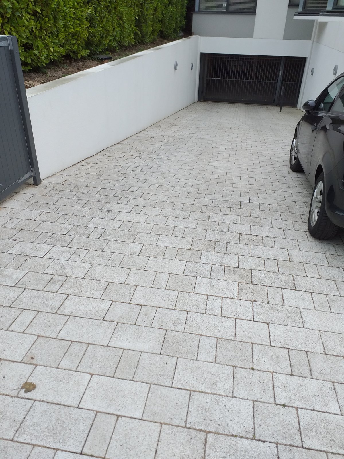

I work on a block of flats and a guy who lives there asks me sometimes to pressure wash the block paving in texts. I heard lots of.people use this method of cleaning then re-sand but I've also heard it affects the position of the blocks so isn't a good idea.

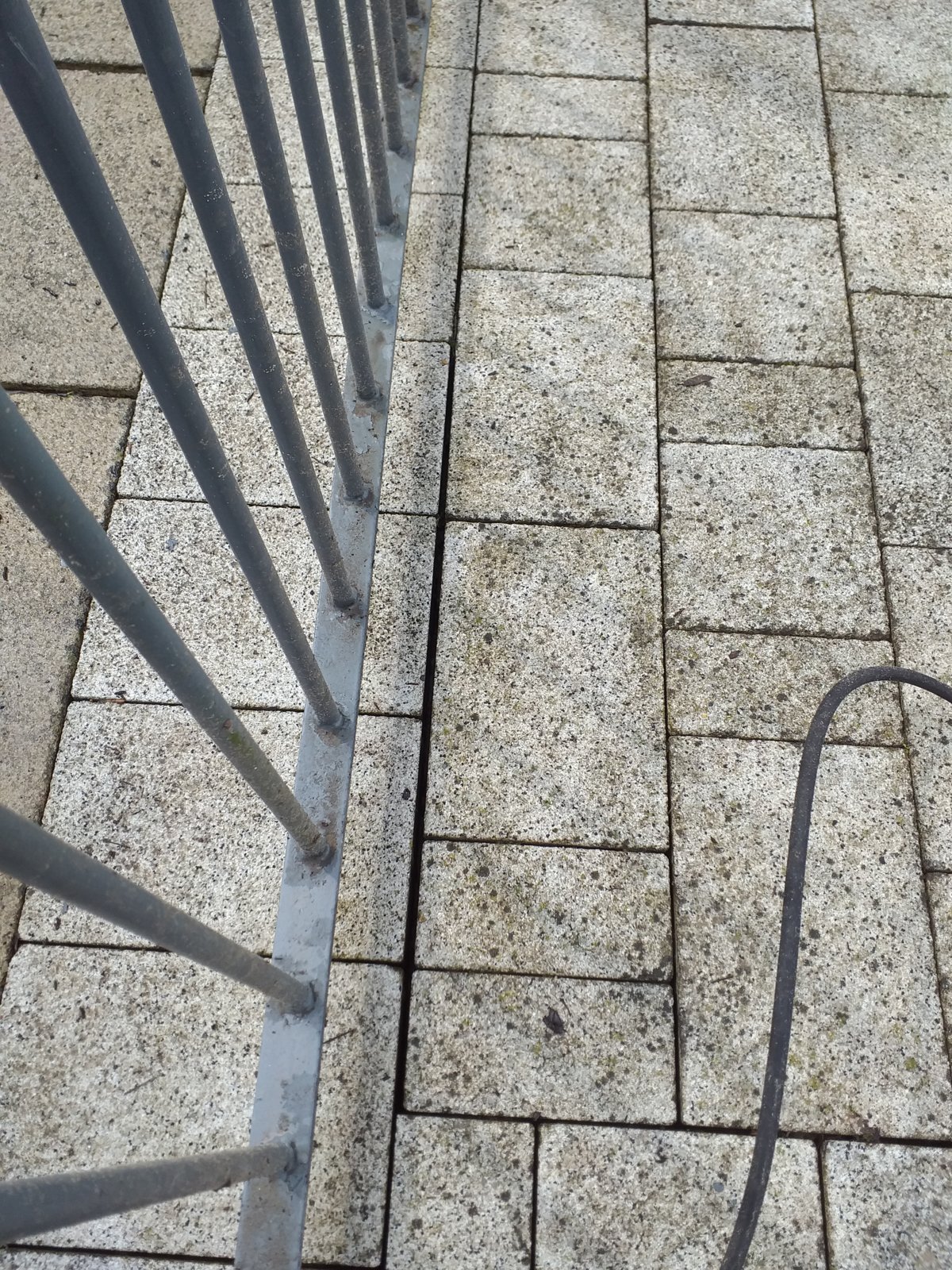

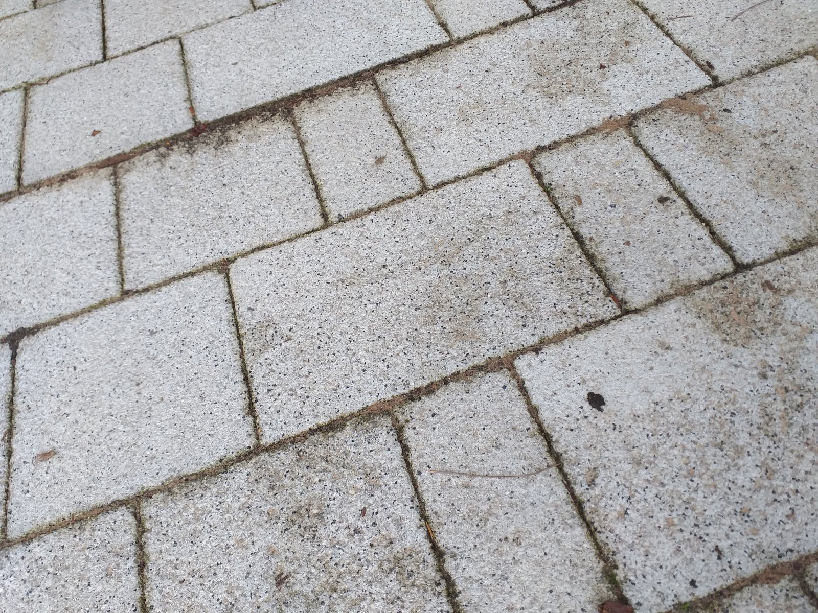

I've been working there for two years and have noticed some blocks are not level with others some a bit raised compare to ones next to them (see pixs) Could I be sued in years to come ?
As I technically work through a property management company who know the law I am often worried about all this?
I recently have been hiring a petrol pressure washer, previously it was just an electric small one.

The paving needs some minor remedial works to sort it.re-sand and compacting again.
The sand has been washed out from under the paving as these are not the drainage type.
Also ants can cause exactly the same problem.
As cana heavy load, skip lorry foot when lifting a skip etc..
No liability as far as i can see, just mention to the company that the paving is potentially a trip hazard as some blocks have become unstable.
Its not serious yet but once this happens it will deteriorate faster due to water settling.

I should think that's a properly constructed paved area.
80 mm paving on a substantial base.
Its normal to get depressed areas from worms ants water, and subsidence in the sub soil.
Your just doing maintenance, dont worry, it's a cost for the company that all companies know they will have to maintain.
Trip hazard and wear and tear, they will need to spend a few hundred or a grand or 2 in time having the paving repaired or larger areas re-laid to a acceptable standard.
