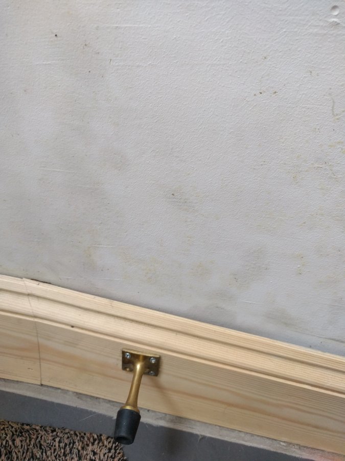

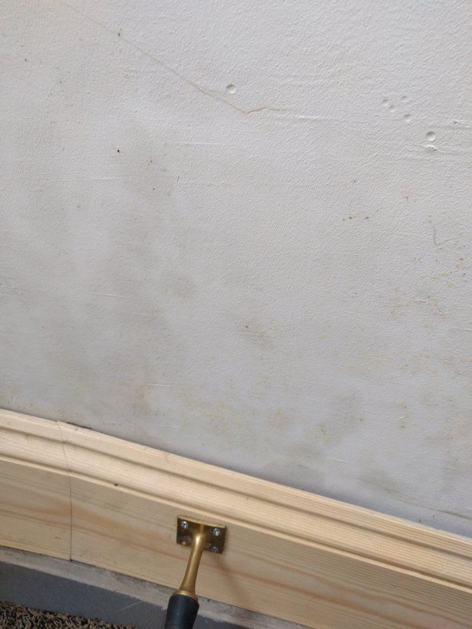

Hi there, sorry for the delay in getting the pictures. The staining is on the replastered section, it was hacked right back to brick first of all as it had completely blown, I presume because that section is open to the elements on the other side.

"the bit by the door" is the vestibule, and if your vestibule flooring is not protected by a membrane (DPM) and some concrete under whatever floor covering then damp will rise.
The garden wall is butting up to the vestibule wall and possibly allowing penetrating damp to enter.
Your neighbour's shared vestibule wall shows signs of damp & decay - being open will allow wind swept rain to wet the render/plaster(?)
FWIW: I asked for more info on sunday?
Typically, you will have to go back to brick, and then render in lime and sand - the hall and vestibule flooring will have to be checked for damp.
Likewise you should examine the suspended floor joist tails for rot.
If possible do this in conjunction with your neighbour?

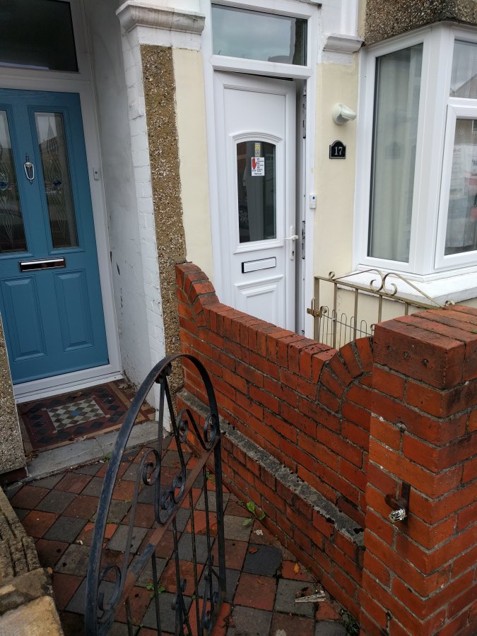

Put up a photo of the porches, gutters and downpipes please.
You could reasonably put up a shield to protect your property.
Just got home from work so will take some after I get up. Her house doesn't have a downpipe as in our terrace there's a downpipe every 3 houses or so, I have one but it's the opposite side of the house.

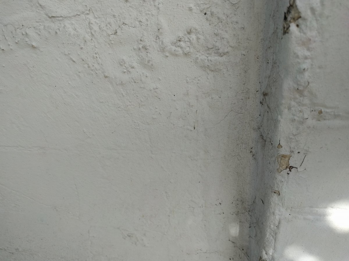

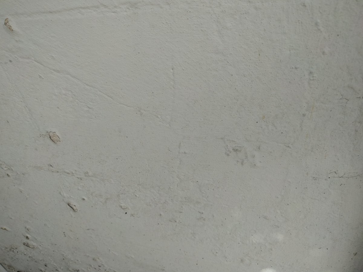

Morning, tried taking some more pictures of the neighbours porch, apologies on the quality, she is in so count get right it to photograph. The render looks quite damaged in the 1st pic which is halfway up the wall, I do have a small yellow mark pretty much where that is but I assume that hadn't got any wors due to how high it is. I couldn't get a decent one of the bottom, but it is just as bad as damage halfway up and my guess is that's where the rainwater is getting in with it being at floor level and not being helped by the guttering being blocked and overflowing into the porch.

Looking at the first pictures it looks like your neighbours porch area is rendered down to floor level. This will be bridging any damp course there is and will be a possible cause of your internal damp. The render needs to be hacked off to about 6", (150mm), above ground level.
To a lesser extent, if the dividing path wall is bonded into the house brickwork this too should have a dpc in it.
