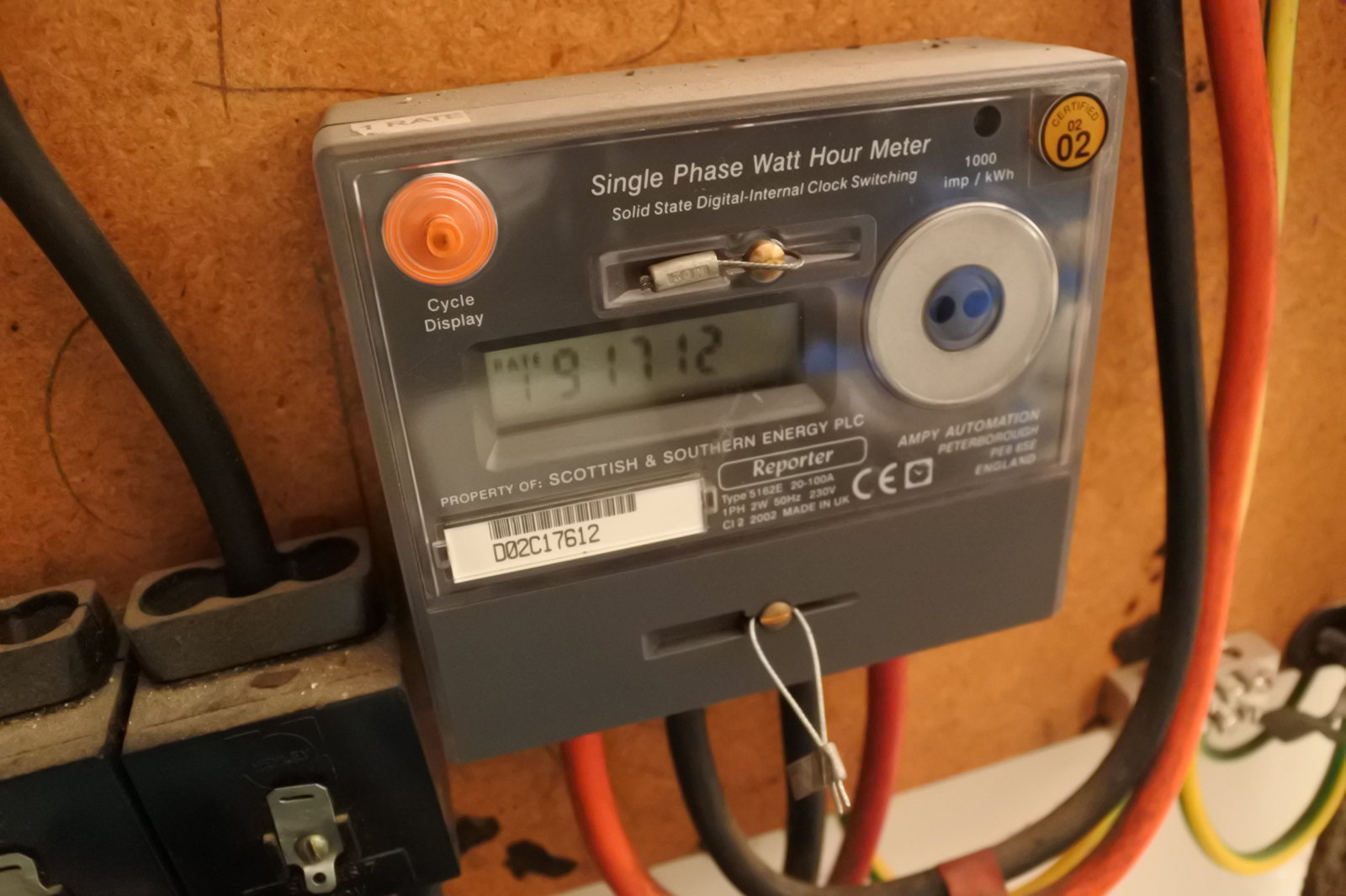

Dear All,
I have contacted my energy supplier as my property seems to be using around 36 units of electricity a day and I believe that considering the electrical items I have on that this is too high.
My energy supplier have suggested I could have a faulty meter.
My energy supplier have asked me to do a test for 7 days which I am preparing to do.

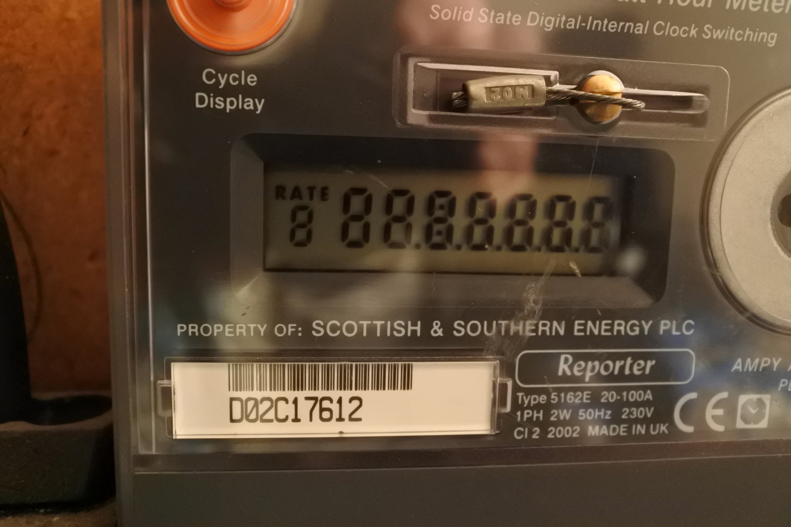

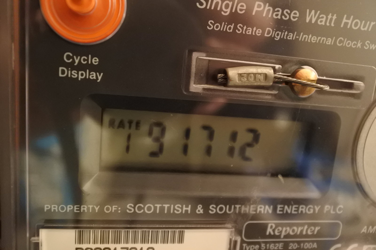

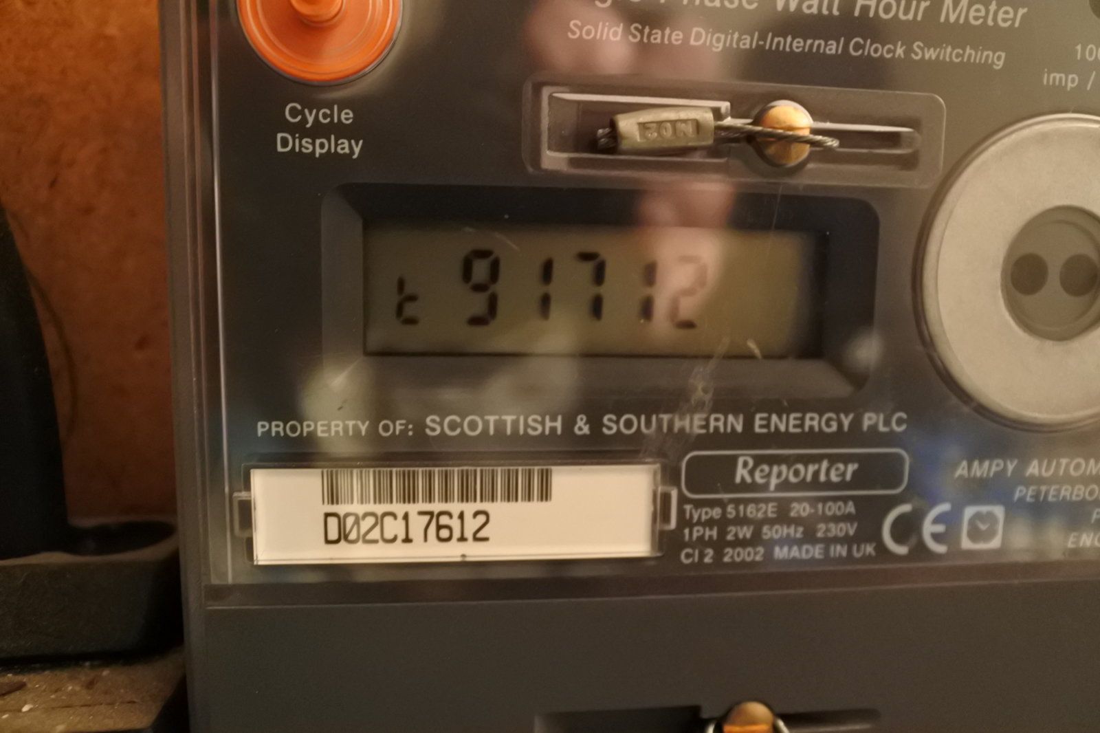

I have attached a photo of my meter which appears to only have one rate. I have then attached photos of the 3 individual displays that are shown when I press the 'display cycle' button.
Are faulty meters a common occurance and is it possible for the installer to have selected an incorrect rate or mode?
Cheers
Paul

nope no storage heaters. the pictures should be shown but there are three displays which are rotated by the cycle display button. These are:-
Rate 1 (and then the units)
Rate 8 (and then 88888888)
t (and then the units)

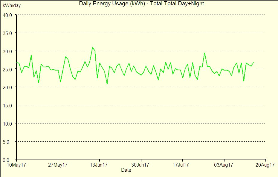

That does sound quite high, given that you don't have storage heaters. I have a very large house but (albeit by being 'fairly careful') I usually run at 25 - 30 units per day.
What sort of electrical items do you use regularly for appreciable periods of time. Storage heaters aside, it is primarily heat-producing items that use a lot of electricity - immersion heaters, tumble dryers, cookers, fan heaters and other electrical heaters etc.

Thanks John, I appreciate your expertise, I do have underfloor heating, but before u gasp(!) I would appreciate an answer to the question about the wrong reading being set. A bit like I suppose someone fitting the wrong miles per hour or kilometers per hour card behind your car speedo!
At least they have acknowledged that the meter could be faulty. I think that is unusual.
I wouldn't say faulty ones are common; not unheard of.
It states 1000 impulses per kWh.
I don't think there is anything to select. They just workout the amount on your bill.

As EFLI has said, I don't think there is anything to 'set', and the accurate performance would have been checked before it left the factory. However, although, as has been said, not uncommon, anything electronic can 'go wrong'.

To give you an idea of what I recently said, the following shows you a typical period during which my ('very large') house was continuously occupied. I use electric water heating, but no electric cooking (other than microwave) and usually no electrical heating of any sort (very occasional fan heaters) - so just the usual lighting plus the usual electrical appliances and equipment ....
Kind Regards, John

Yea there’s nothing to set with a dumb meter. They just power them up and it does the recording. And I guess if they’re dual tariff they’re pre-programmed with times.
