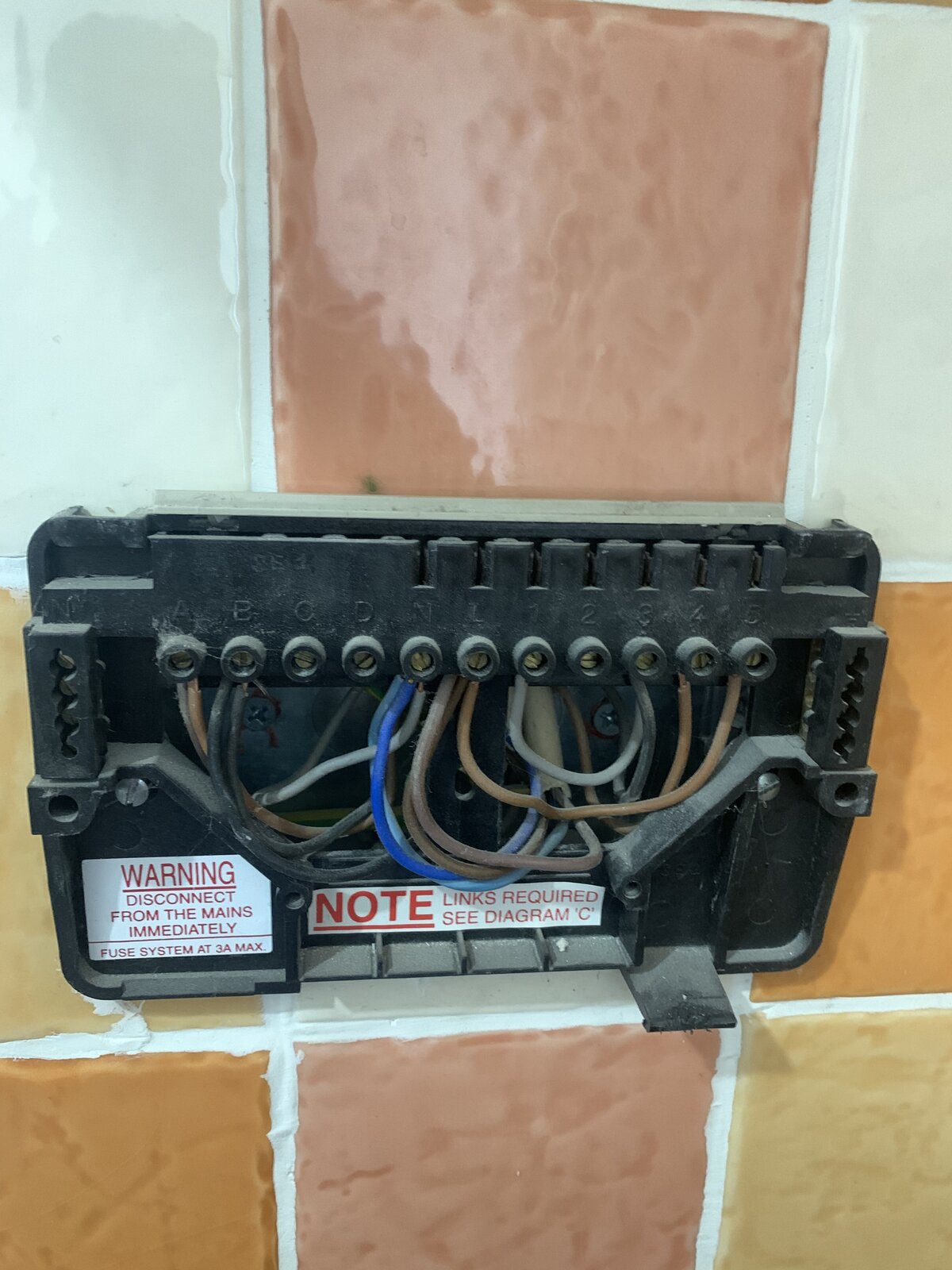

Hi All,
I hope someone can give me some guidance on replacing my current thermostat and programmer with Tado.
Boiler: Potterton Suprima 40L
Programmer: Potterton EP2002
Thermostat: EP2
I have a gravity fed system with tank in attic, hot water cylinder/ radiator pump and shower pump in separate closet on 1st floor hallway. As it stands heating only works of hot water is on- hopefully both can be controlled separately…

That will depend upon the type of plumbing set up that you have. Not all systems will allow separate control without changes to the plumbing. You will need either a 3 port motorised valve, or two or more 2 port motorised valves.
The photo of the EP2002 you posted shows a wire connected to terminal 1 which is 'hot water off' that suggests that you have a 3 port motorised valve installed. However there is a problem. If that is the case, you should already be able to have separate control of the heating and hot water and if you don't there is something wrong elsewhere; in which case I would suggest that you get someone to get the system working properly in its current state first, before attempting to change the controls.
If you have a 3 port valve, it is responsible for starting the boiler and pump when only the heating is required, so the failure of that to happen could indicate a problem with the motorised valve. Something like this is what you are looking for:

On the EP2002 programmer when switching the CH on, the HW also moves to on. And when you switch the HW off and leave the CH on the boiler switches off.

In that case all may be well. The EP2002 is probably set to 'pumped' central heating & 'gravity' circulation of hot water, if it is, then setting it to 'fully pumped' may solve your problem. It tells you how to do it on the back.
Thanks Stem. I’m struggling to get the panel off again, seems like it’s been pried too much and I can’t detach it!
Thanks Stem.
You were right in changing the mode to fully pumped allows me to have CH on without HW.
Much Appreciated!

As per the Tado instructions for Y-Plan I think this would be the wiring from the EP to Tado:
- L to L
- N to N
- 1 to HW NO
- 3 to CH NO
- 4 to CH NC
- 5 can be discarded
- bridge L to CH COM
- bridge CH COM to HW COM
Is this correct or how would I cable?
