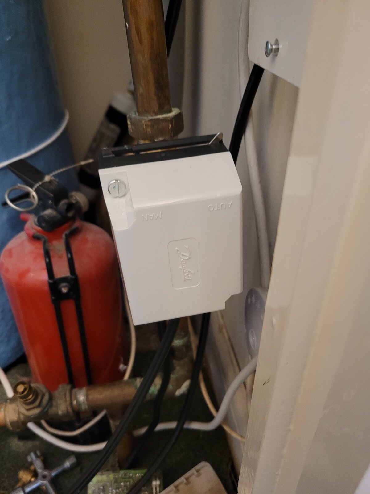

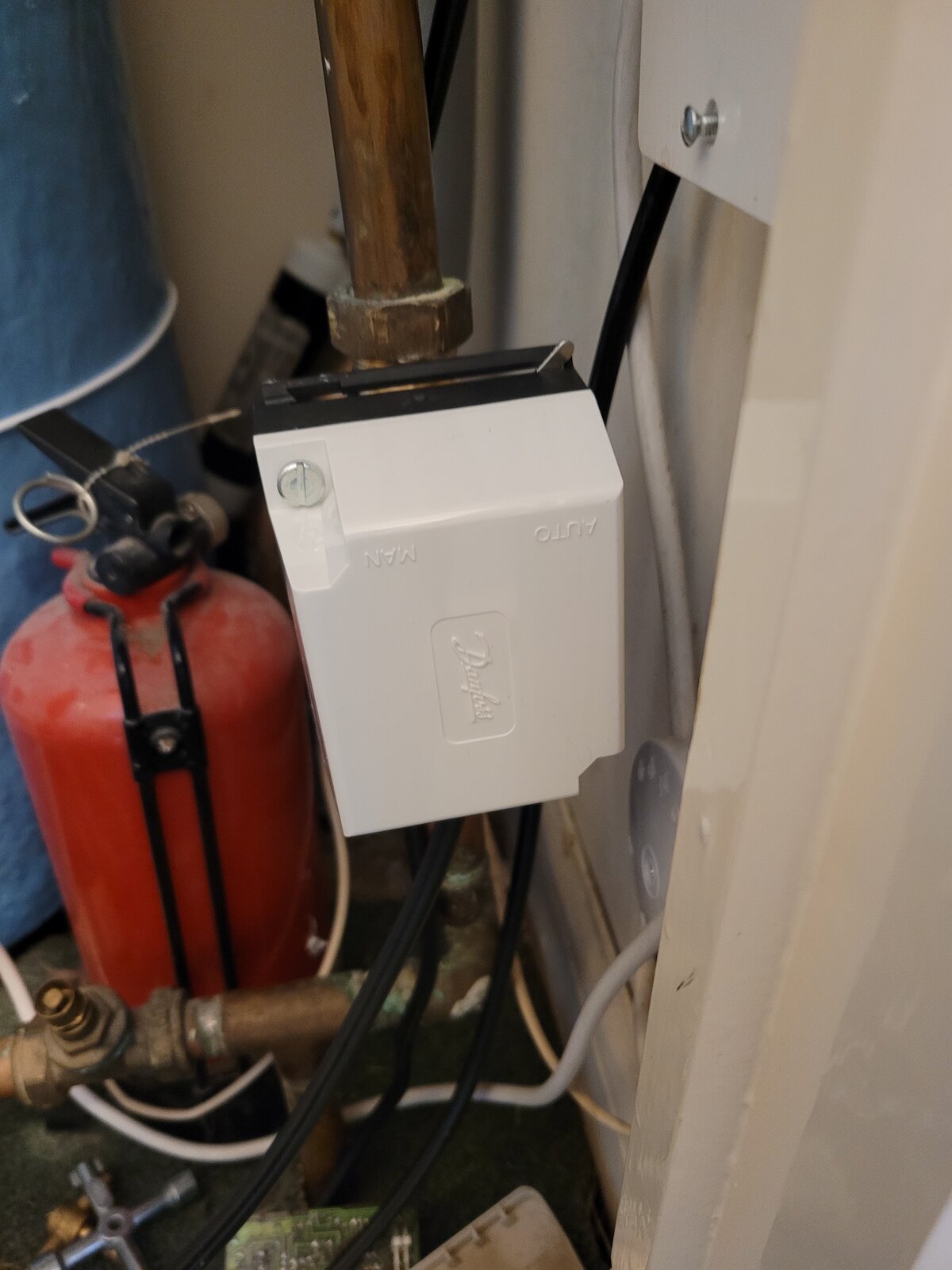

Are you sure it’s a mid position valve? Can you post photo of the valve?
Apparently it is CBW, post #5, even though it doesn't specifically say that. If the Potterton MCP is similar to the "conventional" Honeywell or Drayton where the only way that they will drive the MCP to CH only without a HW OFF wire is if the CH &HW are allways programmed/timed to be on/off together, in which case the HW cylinder stat will supply the HW OFF via its satisfied terminal 2, the valve will then motor fully over to give CH only, if you switch off the HW then the valve will only motor and stay in mid position (via white wire) and will keep heating the cylinder with CH only required. Its strange but the Potterton schematic shows a HW OFF contact but seems to be optional?.

I guess I can check for Y valve operation later by removing the actuator and checking it's movement with both CH and HW on. I'm pretty sure it is....with both on the HW stat does not trigger boiler off when temp reached and room status still calling for heat.
