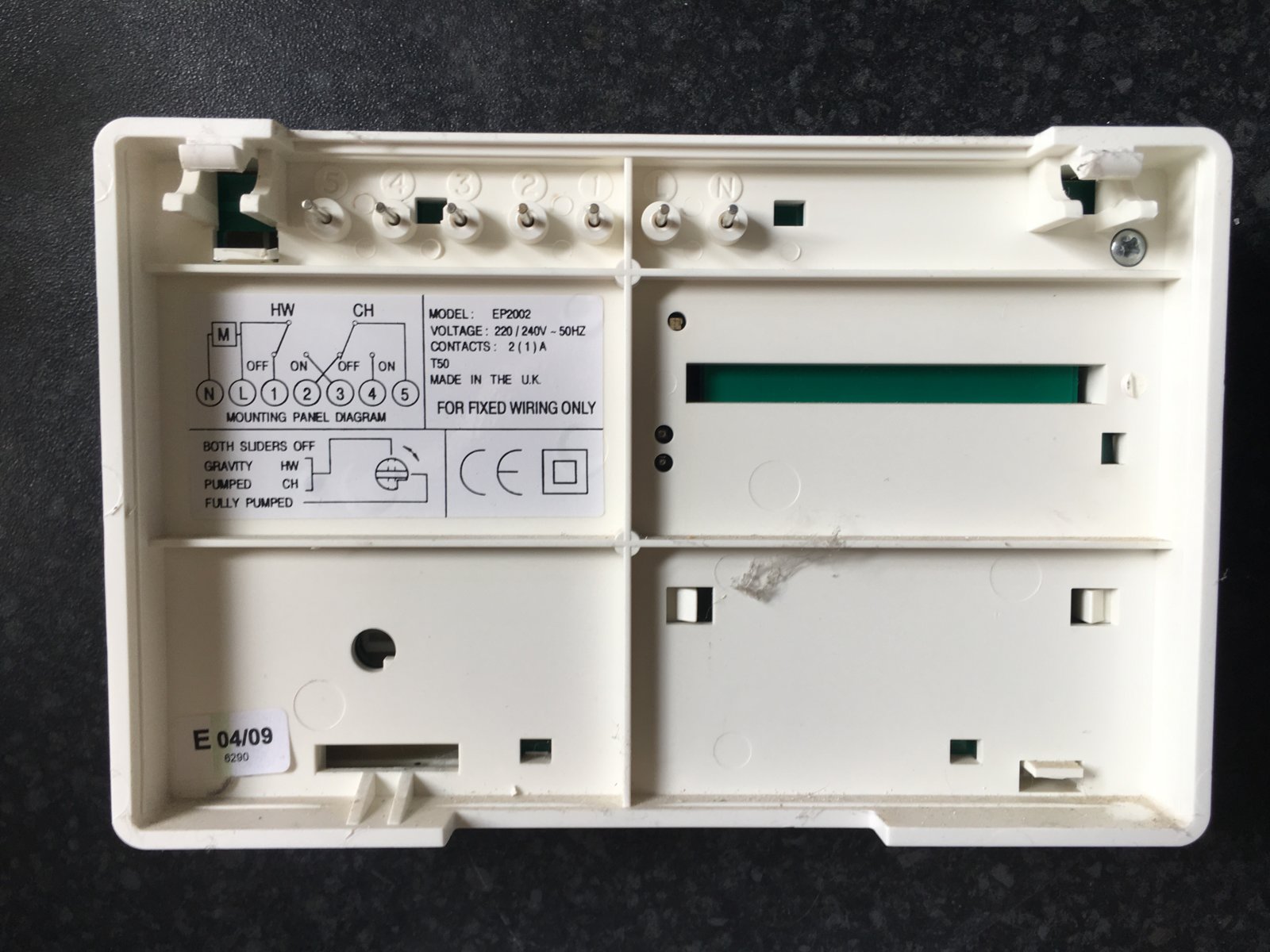

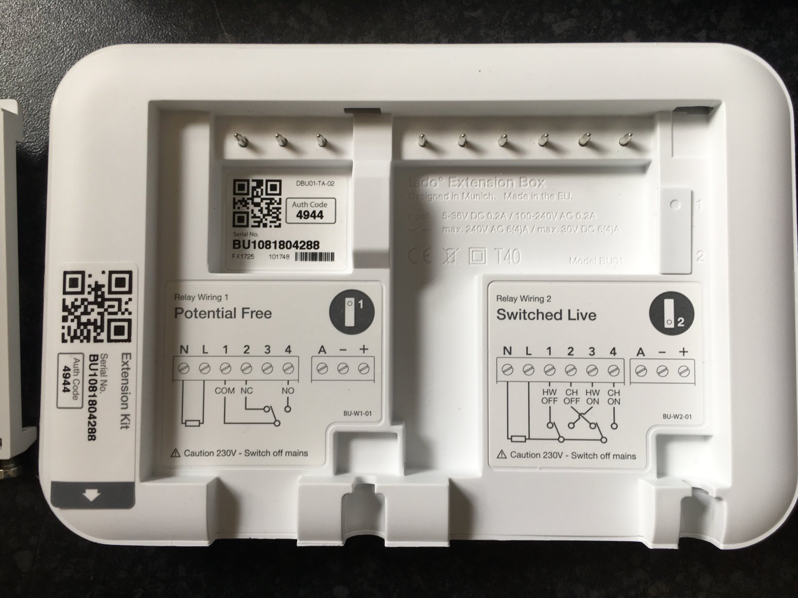

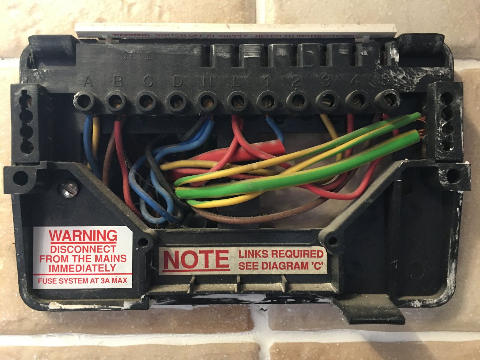

Hi All,
I'm really hoping someone will be able to help me with the wiring situation on the backplate of the Potterton as it's a non standard one and as such will need to swap this one out for the Tado backplate.
The trouble I'm having is that there's no hep available for what working is needed as part of the swap over.
I've taken pics of the Potterton plate with wiring in situ still and images of the rear of both device fronts to try to assist in which wires need to be transferred to the Atari backplate.
Thanks everyone in advance too but I have tried to find a solution by searching but can't see Tado anywhere only Hive!
Keith

The EP is a bit unusual because it is a Programmer and Wiring Centre combined. The terminals marked A B C & D are just provided for convenient use by the installer. They are not connected to the programmer functions in anyway. They are just connectors.
In your photo, it looks as if only A and B are used, so all of the wires from A need to be removed from the EP and then reconnected together as they are now. I usually use a screw terminal and tuck it in the back box. Likewise all of the wires in B need to be removed from the EP and then reconnected together as they are now.
N and L obviously are the 230v supply and should go to the Tado N & L respectively.
The earths need to be connected together, and should also include a wire to the back box in the wall if it is metal.

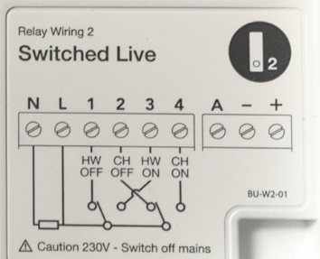

You are now left with the heating control wires, you can identify the function of each terminal from the EP you posted. You can ignore terminal 5 and remove the link between it and L, because the Tado has this internally. The function of the remaining wires in 1, 3 and 4 can be determined from the diagram on the EP you posted.
Then it is a matter of moving the aforesaid wires presently in 1, 3 and 4 to the terminals at the Tado that have the same function again as per your photo. You are fortunate. They are the same. :) Make sure the jumper is in position 2.
HW off = 1
HW on = 3
CH on = 4
